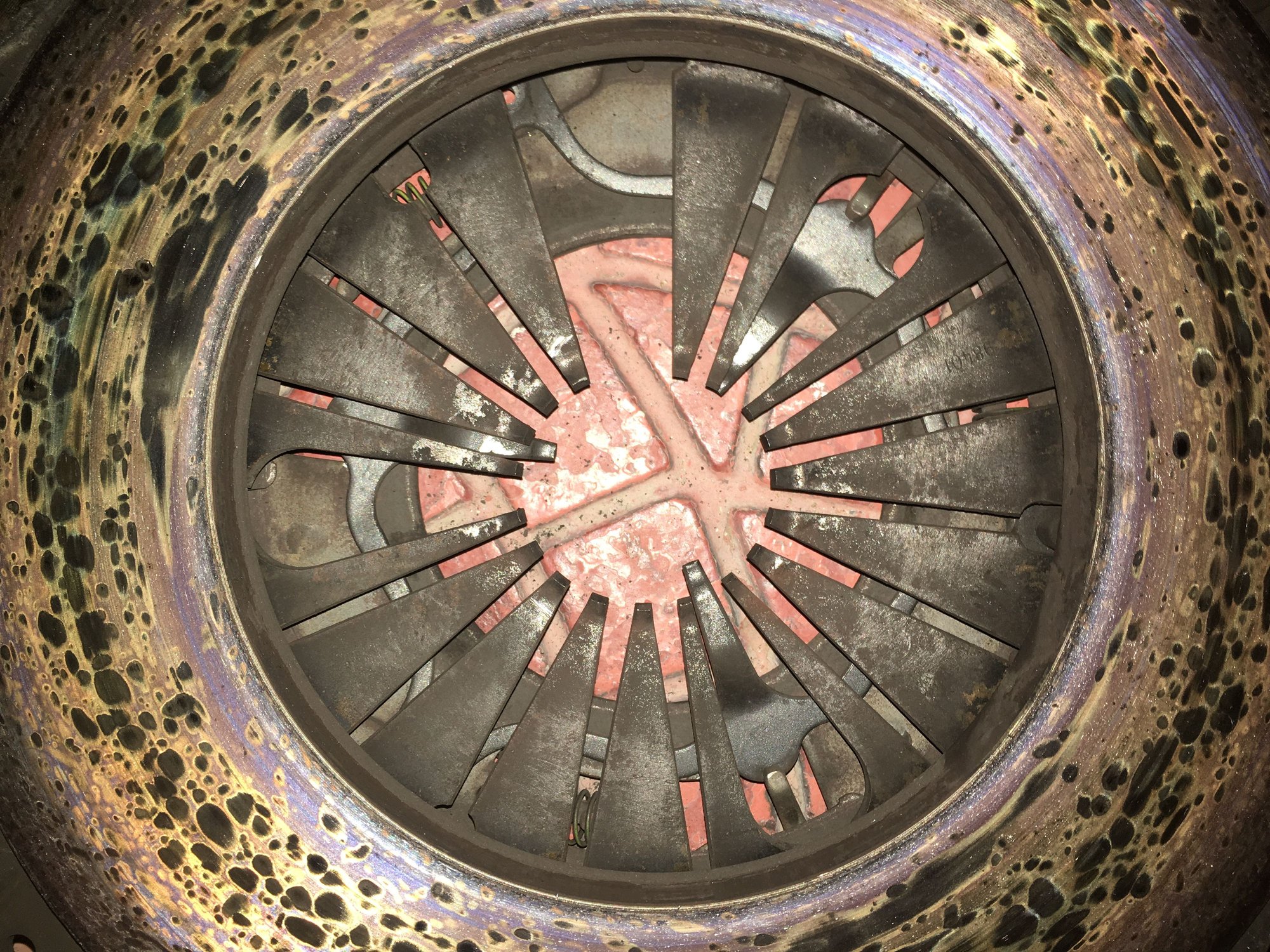

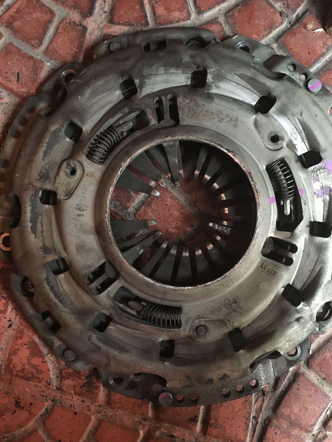

*FIX*
After getting all the parts the pressure plate was broken! Disc looked good along with slave but new parts are in.
Attached some pics of plate and the pin that i found

Looks like you got your problems solved, but I have to ask, hopefully your flywheel doesn't look like the pressure plate, as it appears to have suffered from heat checks on the surface.
Old Jul 27, 2016 | 12:26 PM
Aguita's Avatar
Aguita
Joined: May 2016
Posts: 73
it got heated when it broke i was driving and clutch was slipping, FW looked good
