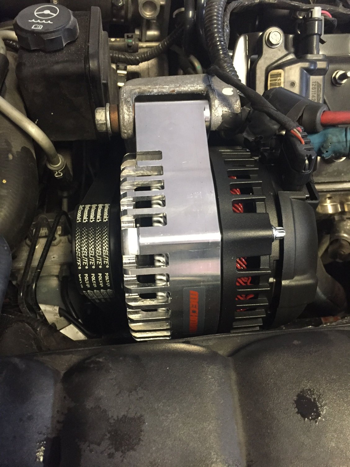

Hey everyone,
Down here in south LA, we're getting daily temps over 100* - which means that proper cooling requires pushing the fan system as far as it will go without melting the connectors. What that also means is that generally the factory electrical system simply cannot meet the demand of running the fans, fuel system, A/C, ECM, ignition, and a 2000 W stereo system simultaneously without putting a heavy load on the battery.
In these conditions, I was seeing the voltage drop down to around 11.5 V, which is far from what you'd want to see considering that you're looking for at least 14.2 or so..
In order to combat this, I installed a Mechman Billet-Tech 170 A alternator, which I sourced from Bret at RKT performance (BLOWNBLUEZ06@RKTPerformance). According to the test sheet provided with the part, it puts out 145 A at idle and 176 A at cruise - both substantially more than could be expected from the factory piece.
Since my car has around 60,000 miles on it, I figured it wouldn't hurt to go ahead and swap out both belts, so I did so with Continental Poly-V belts. For those interested, the main belt is 4060798, and the AC belt is 4040410. These are built much better than the factory ones, and they make much better contact with the pulleys.
Here's a few photos:
New alt and belts - MADE IN USA!:
Old vs. new - quite a difference:
New alt/belts installed:
Note that there is not a ton of clearance between the top mounting bolt and the output stud on the new alternator - I added some electrical tape for peace of mind, although I have no reason to expect any contact between the two.
During my several-hour test drive today, at no point did the voltage drop below 14.5 V - a marked improvement! Typical idle voltage is 14.8 V now, where on the best of days before I was seeing 13.6 V or so.
All in all, I would highly recommend putting in one of these if your alternator is going out, or if you're just looking to upgrade to something more up to the job.

To further the distance from the top mounting bolt, I chose the option of removing the rear section to re-clock, along with an extension for plug in supplied by Mechman in the new alternator and rotate to remount in a different position.
I considered doing that, but after some thought I decided that it wouldn't be necessary as long as I made sure to keep the battery disconnected if the alt ever needs any service (which should be a no-brainer anyway). I figured there was a higher chance of me messing something up pulling the alternator apart than there was from me keeping the stud close to the bracket.
I may be studying electrical engineering, but that doesn't mean I want to learn alternator disassembly on the one that's going in my only car.
The black finish on the alt really does look great...

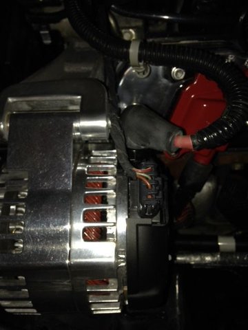

It's very simple to clock it to where you want the plug. I'm turned it so it faces down. Just looks cleaner to me.

How does the clocking work and what additional parts are needed? I saw something about a plug extension? Does anyone have aftermarket valve covers with one of these? I am hoping that it would clear my proform valve covers that I had to clearance my stock alternator for.
I can't imagine the Proforms being taller than the Katech and my alternator fits them just fine, without any clearancing. The billet alternator provides about 3/8" more clearance on the bottom compared to OEM units.
Clocking can be done carefully and at the risk of the buyer. I do it with the alternator face down on the bench, using a soft towel to prevent any scratches on the pulley. Remove the 3/8" nuts and then the plastic rear cover to expose the 4 inverted Torx bolts, also called EI. If I recall correctly, it's an E6 socket that's needed. Remove the bolts and carefully turn the back and front cases in opposite directions and in 90 degree increments until you've got in the desired position. Insert the bolts back and tighten them to 62in lbs. Re-install the rear cover and the nuts. Tighten them wrist tight (about 30 inch lbs).
I can get you an extension. They cost around 35.00

Did you need a (harness or power wire) extension to do this?
Attachment 47999305
Old Mar 12, 2017 | 08:34 AM
realcanuk's Avatar
realcanuk
Joined: Apr 2011
Posts: 7,820
Likes: 408
From: Montreal
St. Jude Donor '13
No. Wires reach no problem.

Awesome, I'll use the writeup that's in here or try and find a video that shows how to clock it.

There is no real need to clock the stock Mechman factory position, unless I am missing something. My install put both connections in place with plenty of clearance. The plugin harness is not stretched or out of place. The primary voltage cable fits with a positive mechanical bolt in place connection and a rubber boot. This connection is almost as good as being welded in place and it might as well be a mile away from the alt bracket. There is no need to tape it or anticipate it is going cause a short.

Understood but if you clock it 180 degrees, it leaves you with a cleaner look and the attachment point for the cables under the alternator.
