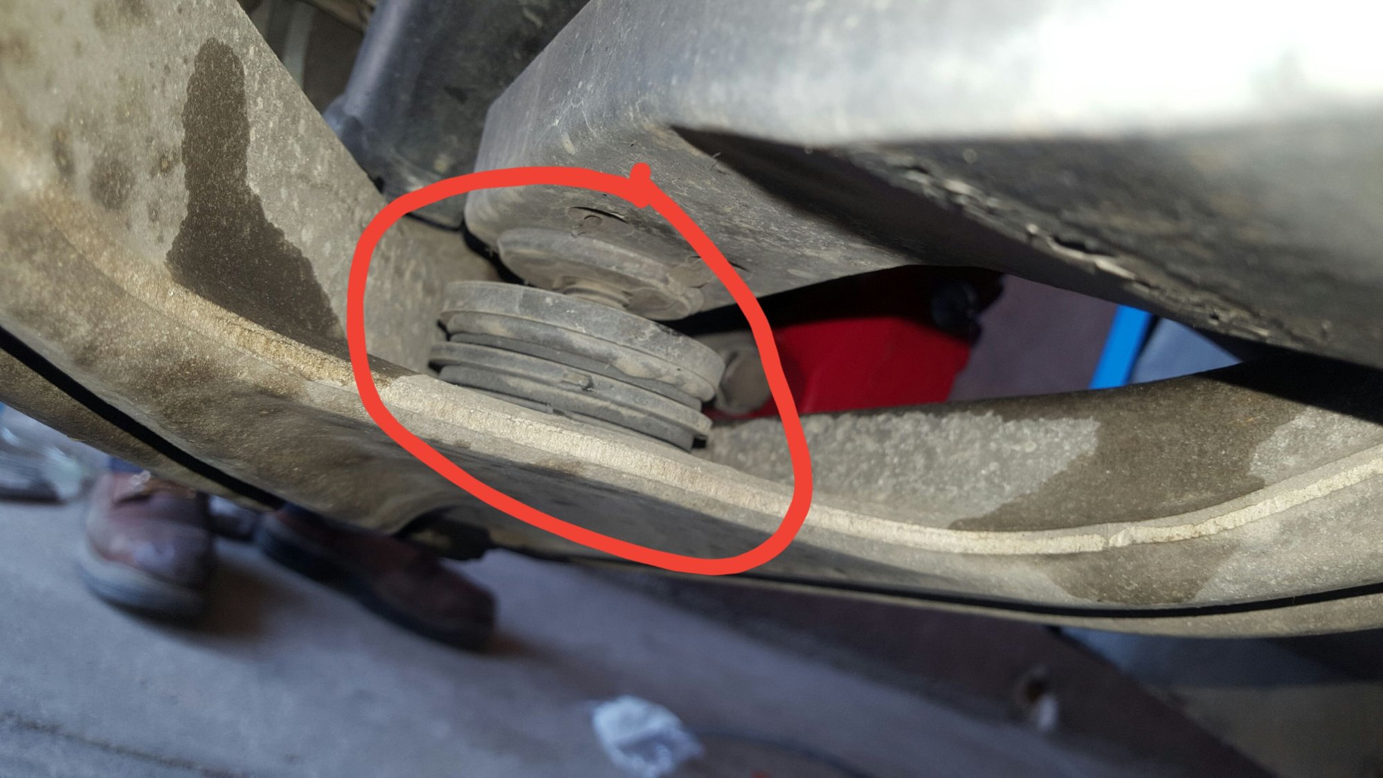

So my car is tilted from the right side front and rear. Installing wheels and brakes on the car and saw that the bushing pieces are gone. Completely wasted ripped rot dead.
These pieces. This is on the rear left and is still good.
I called three way chevrolet dealer in bakersfield and they had me go to their parts department to explain to them exactly what i was looking for. Im not sure what the bushing pieces are called but we managed to find it. Well they told me i would have to buy practically the whole suspension part for 600 bucks! And that was just the one front side. They couldn't sell me just the bushing. I ran out of there as fast as i can.
I tried searching on Google but i just can't find the name of the pieces.
Does anybody know what they are called and where to get them? I just need the front right and rear right. Please excuse my lack of knowledge im a noob to this.
Thank you

not familiar with what you are showing in pic
on my 97 I replaced all the bushings with poly urethane
should not use GM
search for suspension poly urethane

Look at this link
https://www.vansteel.com/index.cfm?f...p=1951&ID=3476
Ride height is a bit lower than stock but it worked for me when my adjusting bolts were cut.

Are these really what i need? If i get these i would have to get all 4.
Not really necessary. I replaced only rear two. Front bolts are stock.
Thank you
"Ride height trim adjuster bolts" or "lowering bolts". They do not have a part number and are not available separately. This has been true for three generations of Corvettes and no one knows why.
Mine were like yours. I replaced all four of mine with reproduction bolts from Corvette Central:
http://www.parts123.com/corvettecent...50h&ukey=51135
These are the only OE reproductions I know of. Most aftermarket bolts are shorter, in order to facilitate lowering the car. Many aftermarket bolts are also known to wear out quickly.
The ones Corvette Central sells are clones of the rear bolts, which have a larger diameter, but they sell them for use in front or rear. I installed them a month or two ago. We'll see how they hold up, but so far so good.
Wow thanks a lot man! I just ordered 2 pairs. Hopefully they don't take too long to get here as im in a tight situation. But i guess these are the ride adjusters too. Very nice. Ill install all 4 when i get them and im excited to do so. Thanks again and to everyone who helped me.
You're welcome.
Regarding installation: if you're lifting one corner at a time with a floor jack, and using a separate bottle jack to lift the spring, I found it helpful to disconnect one roll bar end link. That increases the amount of suspension droop so you can get more clearance between the control arm and the spring.
Might as well leave the end links disconnected until you're all done so you can take ride height measurements without concern about preload from the roll bars.
It took about two rounds of adjustments to get mine dialed in. I'd drive around the neighborhood, over speed bumps and so on to settle the suspension, then return to my very level garage slab and take measurements from the floor to the top of each wheel arch.
I set it up for 26.5" front and 28" rear. The subframes were level left-to-right and the front-to-rear rake (measured at the frame rail lift points) was about 1/2". This was with a full tank of gas and new tires. It's repeatable to 1/16th" and hasn't budged. Later I had the car aligned because it had been a while.
A few people report that their adjustment bolts are frozen and won't turn. The usual advice is to soak the threads in penetrating oil. I didn't have that problem.
