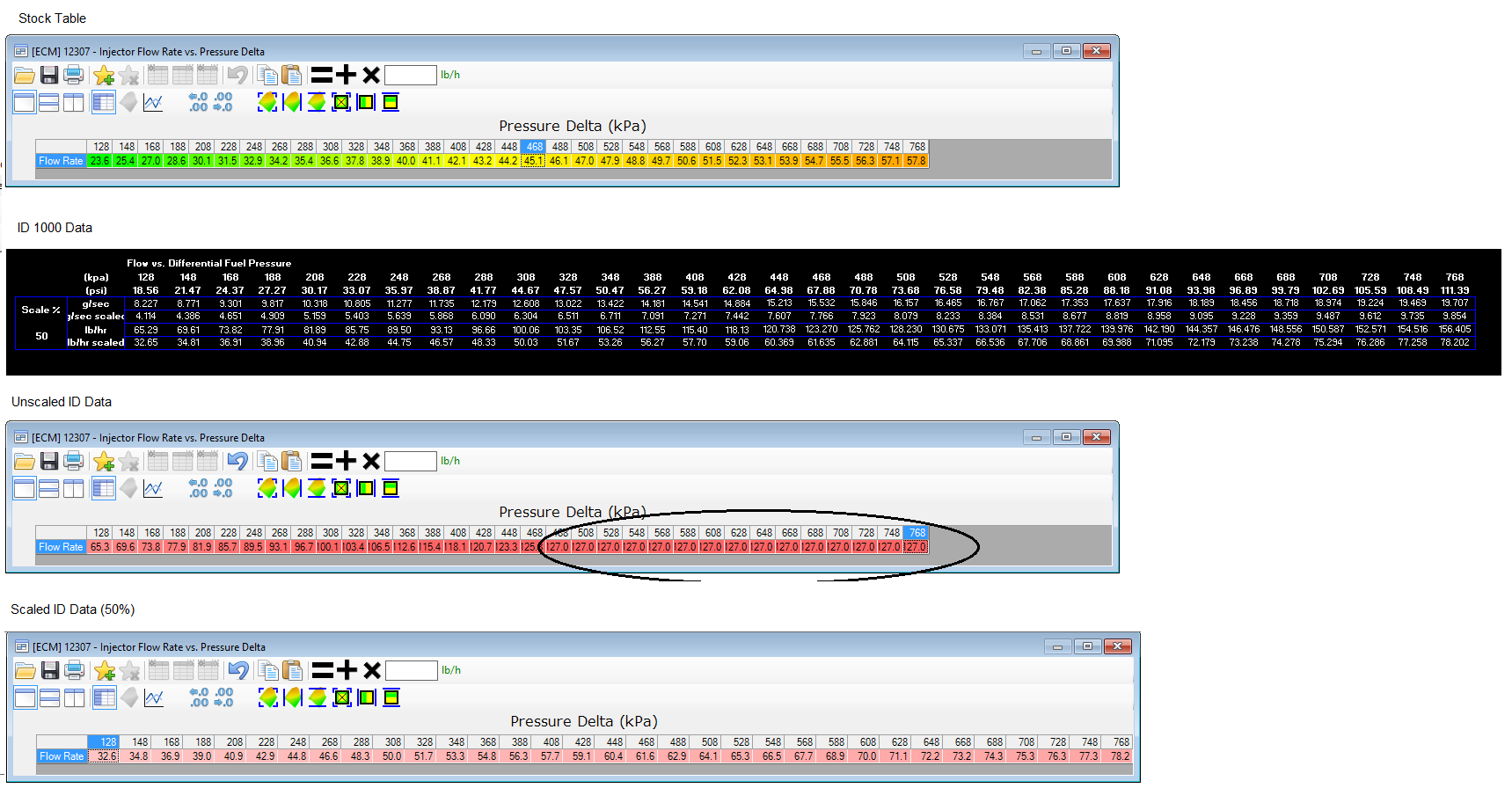

This is the way I understand it:
Scaling down 50% doesn't clip the max limit to 127 and gives the computer 32 values between 128kPa and 768kPa to work with rather than 20 values since everything above 508kPa is limited to 127 when not scaled. The computer uses interpolation to find the proper injector duty cycle between the 2 values and the 50% scaling provides more info to make the final injector duty cycle more accurate. The side affect of scaling is other tables like AFR and IVT need to be mess with.
Not sure if I got this right or need to start smoking weed again to full understand it, nor do I know how important the BS really is...Just know that different people set it up differently and everyone swears by their approach.

Carson.. You're one of the few tuning experts I trust to take advise without questioning it. What you suggested, in addition to changing offsets and short pulse adder, is exactly what I did last week and thought I was done....Then I read this: http://injectordynamics.com/articles...ation-scaling/. From what I got after reading this is a lot more than 2x stoich needed to be changed and then started to question if I was in over my head.
Sounds like the info in that article doesn't apply to me and all I have to do is copy flow rate at 100%, offset and adder and it's good to go?

That is another way of doing it and will work, but unless you are maxing out something like the MAF airflow values then there's no reason to go through and scale everything. It's a PITA and you lose a lot of resolution on spark tables and everything else that references airflow. Just my take.
The double stoich/half IFR way effectively cuts the injector PW in half (when doubling stoich value) then doubles it when you half the injector flow rate, so it works out the same. 1/2 * 2 = 1
Multiple ways to do it.. either can work, this way is the easiest IMO and works for most setups. I like easy.
On some of the older computers the airflow limits were a lot lower so you'd see guys in the 600rwhp range maxing MAF airflow tables out and then they'd need to scale anyways. Not so much anymore as GM has higher limits now starting with the LS3's. They used to max out at like 512 g/sec. The limits are now something like 4000 g/sec which no one here is going to max out.
So, short version is either way will work, double/half is easier and a whole lot less chance of missing something, in my opinion anyways

Easy is good for me also. So let me see if I got this straight. The flow rates on IDs data are based on differential pressure across the nozzle. Since I run around 60 psi (Green arrow) flow is about 116 lbs/hr which is under the 127 lb limit for my ECM. I would start to get into trouble at 72 psi (Red arrow) because that gets close to the 127 limit so in that case I would half the flow and double the AFR without any other changes required.

You'll never actually get to the 72psi portion of the table, so in your case no reason to do either.
At absolute most you'd be at 58psi fuel pressure + say 9psi of vacuum = 67psi effective fuel pressure at injector tip. Even if you got to 14psi of vacuum that's 72psi at the injector tip so that'd be the most you'd ever see if somehow you saw a whole lot more vacuum than I do.
So, it doesn't really matter in your case. You can just put in the original 100% unscaled values and be good to go. Some of the upper cells in the table will be maxed out, but it doesn't matter because you'll never get there. They are really only used on setups with fuel pressure control modules that increase the base pressure beyond 58psi, but the tables are there regardless.
