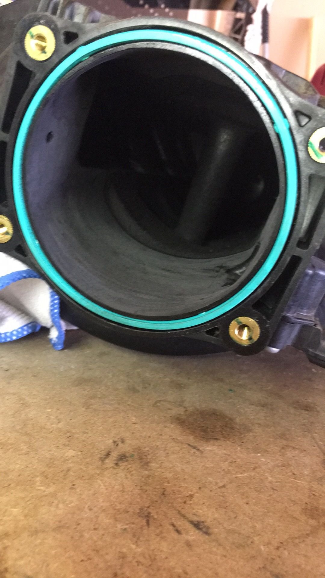

I went ahead and pulled my intake manifold off yesterday and it's being shipped to Gwatney today. Your thread inspired me to act.
Before last night I had never removed one nor looked at one up close, it's hard to imagine how porting that thing could make any real difference.
