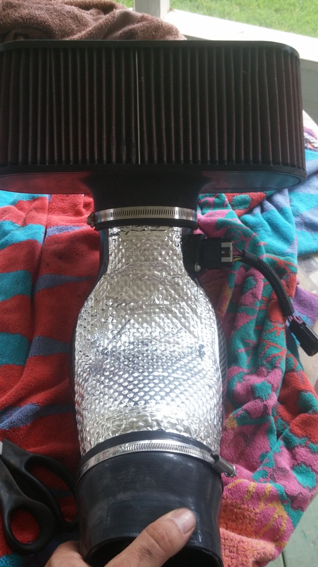

Cleaned the intake up real well and insulated the bottom while it was off.
I'll get it installed over the weekend.
Old Oct 7, 2016 | 07:23 PM
Suns_PSD's Avatar
Suns_PSD
Joined: Oct 2012
Posts: 8,434
Likes: 411
From: Texas
I went ahead and insulated the bottom of my air intake too because I noticed it gets scorching hot during the summer.
But you can't see it from the top once installed.
I'll let you know if it drives any different in another day or so.
