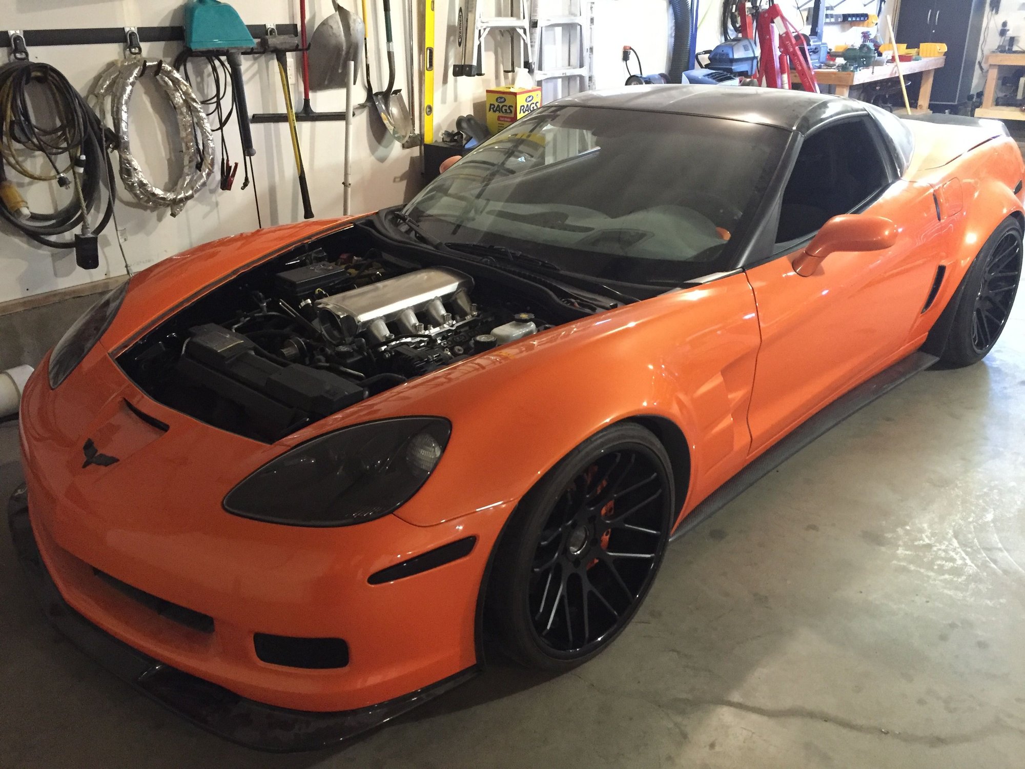

And since threads are useless without pictures, here are a few terrible shots of the car right after I got the engine back in.
