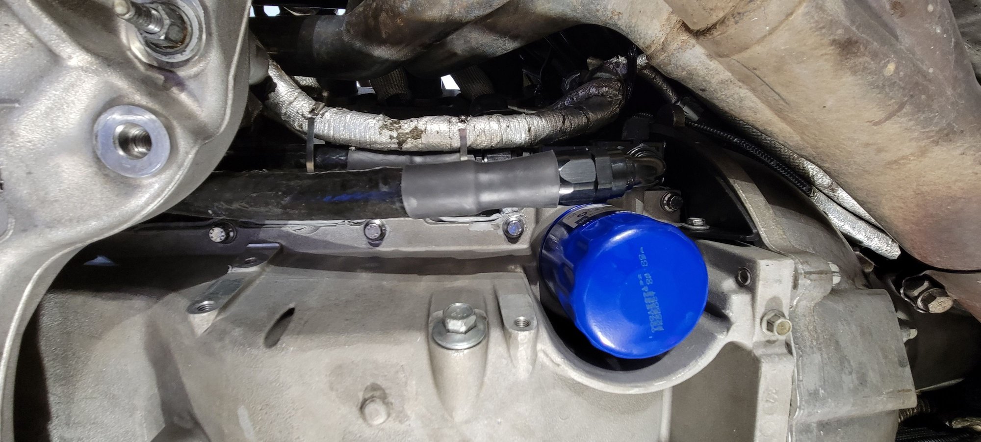

You can also go with a dedicated oil cooler setup and dump the coolant to oil factory cooler. That will bring coolant temps down a good bit and also help with keeping oil temps down, if you get the right setup.
