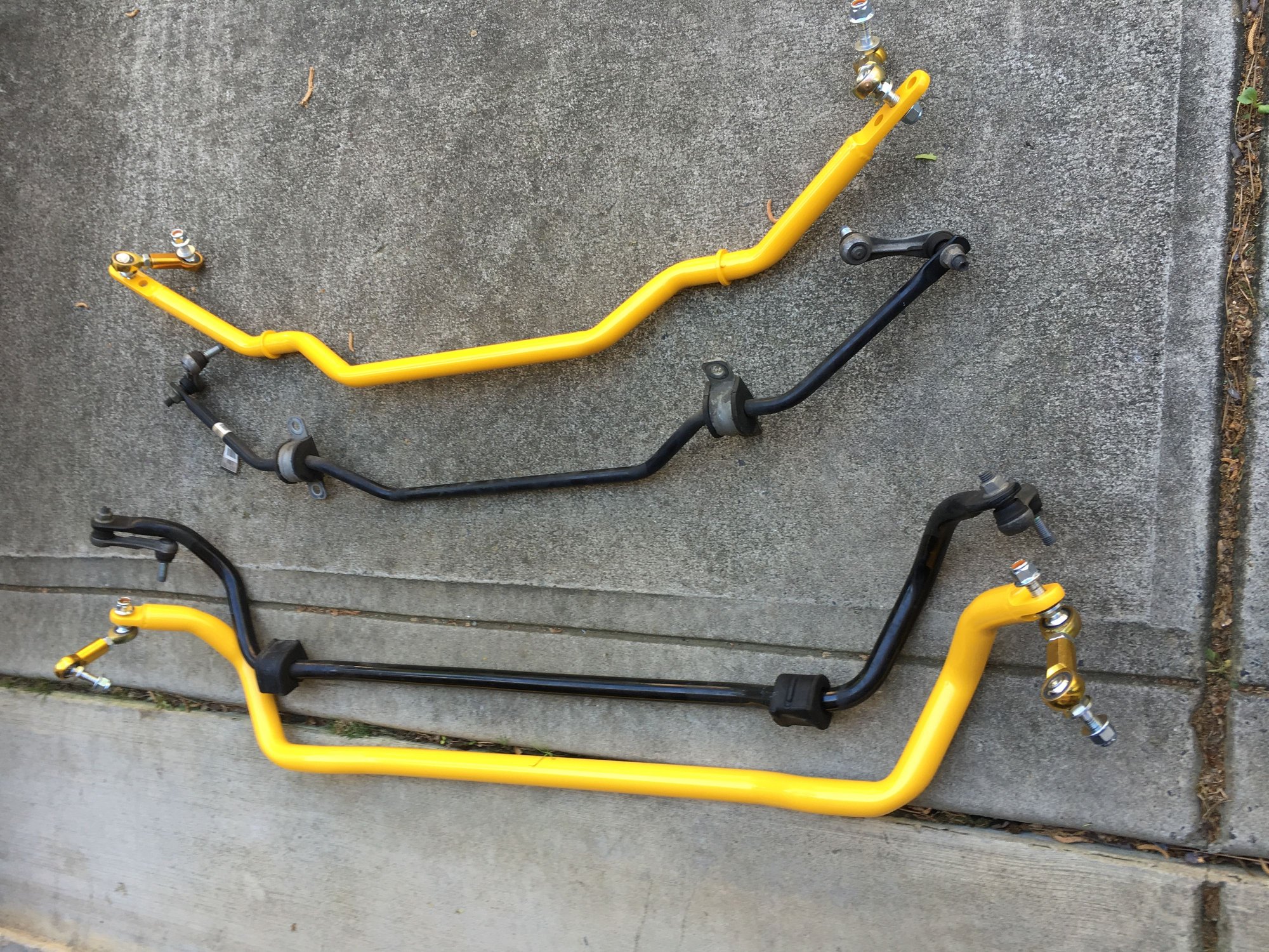

I went with Johnny O'Connell sway bars front and back, which came complete with much better end links and adjustment, too, so you could refine how stiff the bars were, or set them softer for the street and tighter for track days.
FYI, here is a shot I created with the sizes and comparing looks, too:
Note: I had the rear bar installed before I thought to document what I was doing, which is why it isn't in the shot, but it's diameter is given.

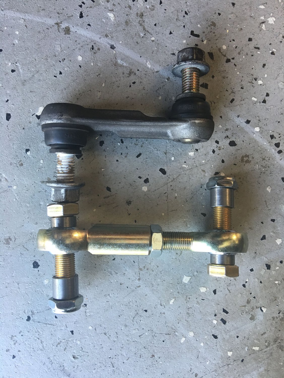

So I was looking to upgrade my sways as well back in April my issue was back end kicking out over bumpy roads. Mine is a base C6 non Z51. I had done a C6 Z06 shock and Z51 sway bar swap on my C5 years ago and made a huge difference in this respect plus it handled like on rails and I was leaning in that direction. I figured for a little more money I could get some decent shocks and better sways so I started researching. There are 5 or 6 of the popular sways, and about as many shocks that you will see folks recommend here. My issue was what combination? Koni's and LG, DRM and Hotckis? You are looking and a lot of combinations and how well do they perform together as well as how predictable the combination would work together. I came across the Johnny Oconnell shock AND sway package.(Google the video of them engineering this package.) And while they are really just the stock Z06 shocks re-valved and DRM or Koni's may be a tad better, its how well the package works together that I was looking for. For me they worked out really well, my measure is a sharp downhill right hander very bumpy that I could barely take at 50. i am now able to do it at 70 NP with my stock GY RFT. I have since upgraded to Michelin PSS and could probably do it even faster.
I am very happy with the combo they ride real nice and a definite improvement in handling. Car is very neutral now I have a lot more confidence in the back. I got a great deal they were running a sale i got them for like $1100. Most other combo's will be in the same price range (except C6 Z06 shocks and Z51 sways) maybe more.
If you do go this route, a couple of install tips;
Make sure the sways don't bind in the bushings. I had to shim the bracket to frame connection with some big washers from Lowes. The bracket is too small and if you use the bigger bushings needed for any bigger sway bar they will not move and that's not good they have to be free. You don't want them sloppy loose, but they should be able to move. I had to grind the washers to get them to fit on the frame correctly I think i ended up with 3 under each bolt hole. Again you will probably have to do this with any larger swaybar using the factory sway bar bushing bracket.
When using the adj end links on the rear leave them disconnected and load the cars weight(i put all the tires on and lowered the car onto ramps) then i used the middle hole. You will have to adj the end links to fit when it loaded there is only one length that will fit.
For the fronts I noticed that I could use various lengths to get the endlinks to fit. A quick call to AFe and they said to set it for half way to start then adj if front is too tight or loose. For me this setup has made my car neutral no front end push or rear end kick out.

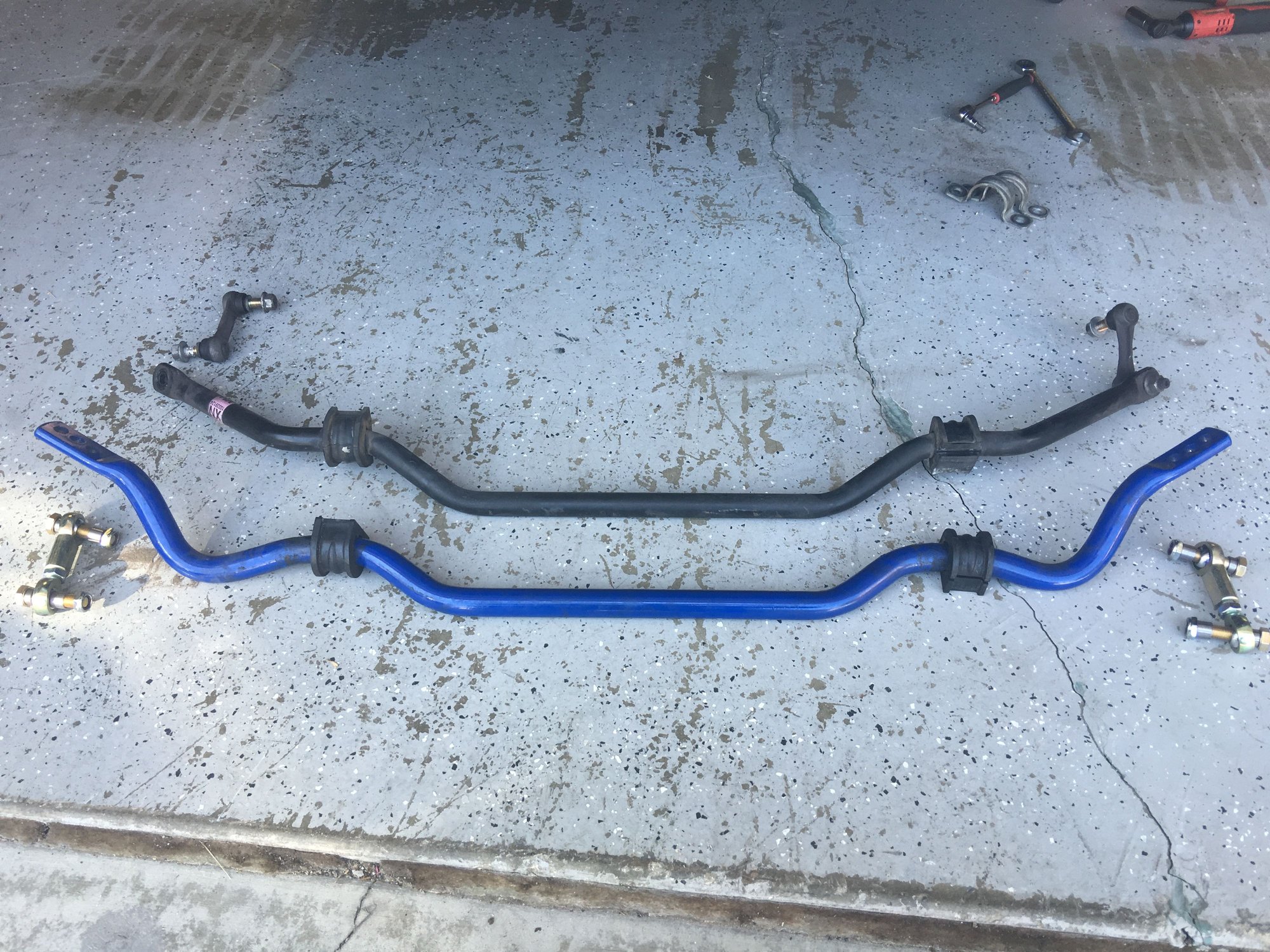

After looking at the attached jpg, borrowed from somewhere on these forums I installed Bilstein Sports and front/back Hotchkis Sways. Massive handling improvement in the curves; +10-15 or more mph easy on threadbare Nitto Invo tires.
Dam that stock rear bar looks like a twig in that photo!!!
Yeah - I learned from a bunch of work on a different car some years back, that these kind of improvements make a real difference for track days. That said, the stock set-up is no slouch for around town. Many cars don't even have sway bars, which help reduce the side to side flex that can happen at higher speeds, as the vehicles weight gets thrown around.

Originally Posted by CMY SIX
there is a reason why the factory puts the heavier one in the rear on a base
That is incorrect. The factory puts a larger diameter bar in the front. On my base C6 coupe, the front was 26mm while the rear was only 17mm, as shown in the image I included in my post.
