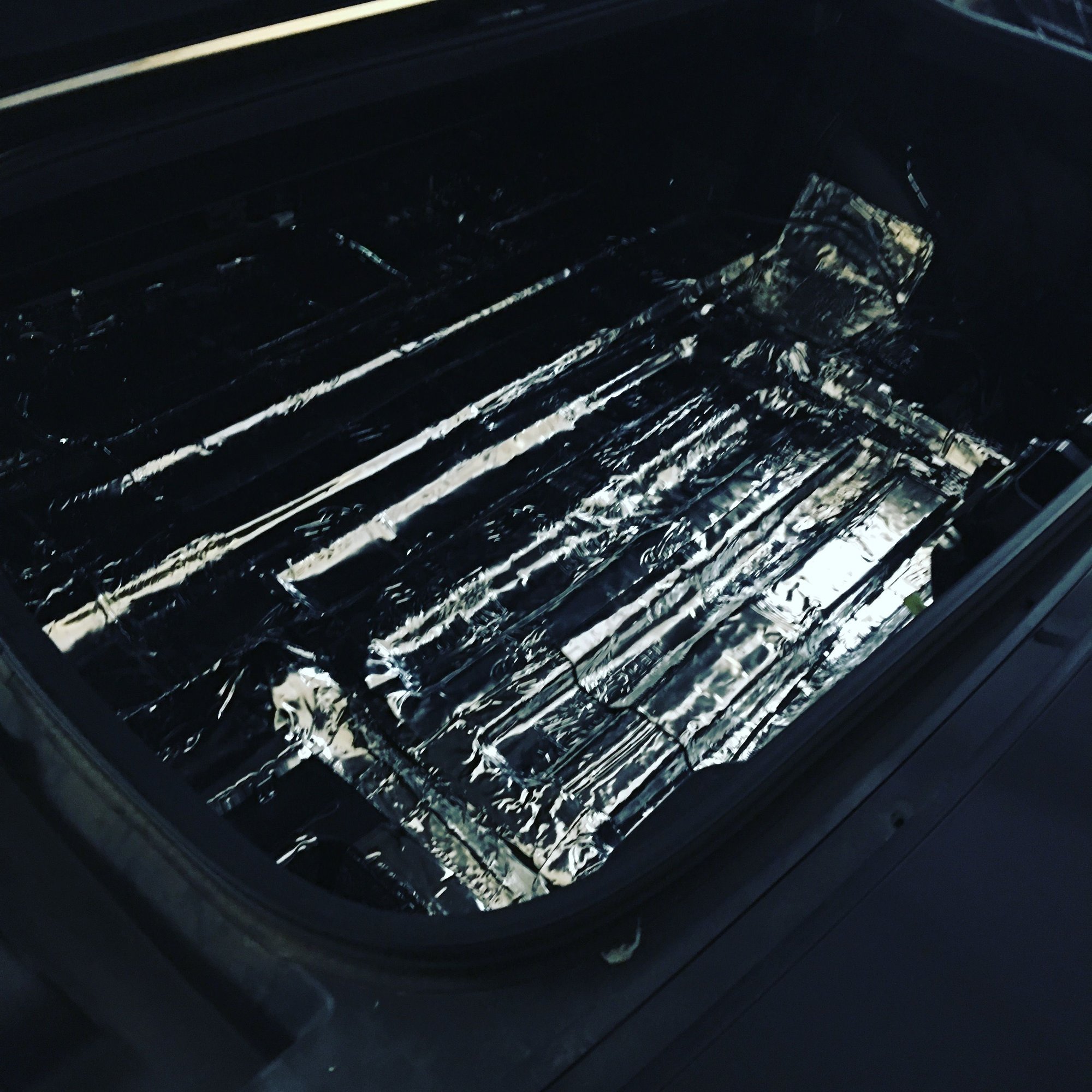

As some of you may know, I have a huge drone problem now after dropping in my 408 stroker...I'm under the car and plan to add some acoustic barrier stuff and noticed this plate.. I'm assuming it's to act as a heat shield, but I'm thinking this is a big contributor to the drone, I have a convertible and it's unbearable even with the top down!

I did remove it and installed BoomMat tunnel and shield insulation, and I didn't reinstall the metal plate. Also added road kill sound dampener to the trunk, it killed drone and vibration by about 25%,
