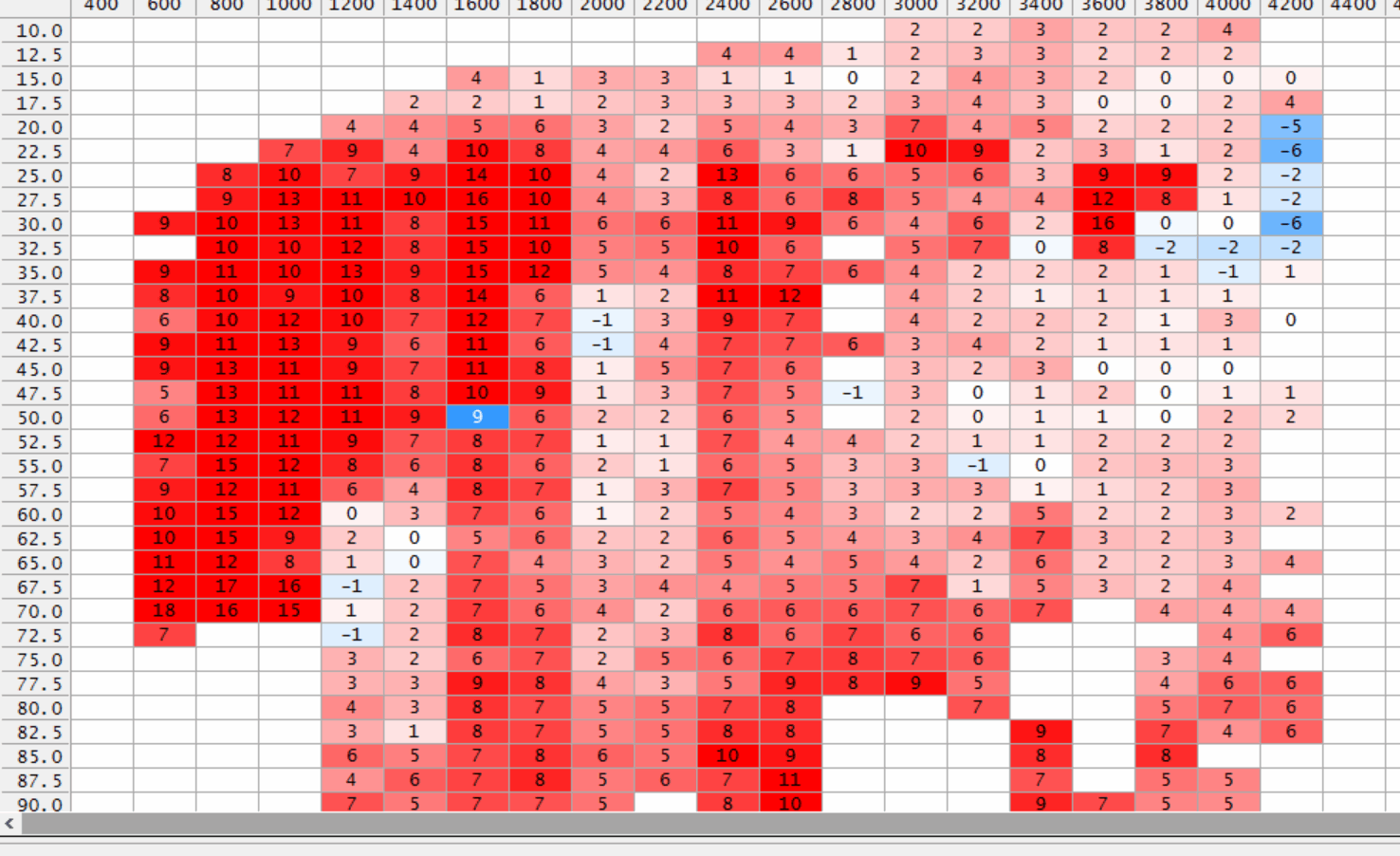

Hi Guys,
I created a Maths STFT + LTFT log attached below. Which table should this go in HP Tuners? Trying to dial in regular highway/city driving.
Thanks

Edit-->virtual VE editor, change to manifold switch open before making changes.

Am I multiplying this by 1.10 for 10% or adding 10

Multiply by %

Can you elaborate more on manifold switch open?

There's a drop down box on the left in virtual VE editor. Change it to manifold switch open before making changes, otherwise you're making changes to a table that isn't used
(I'm assuming you're using the stock OS since the histogram you have setup is based on the stock OS--if this isn't the case then histogram is setup wrong)
