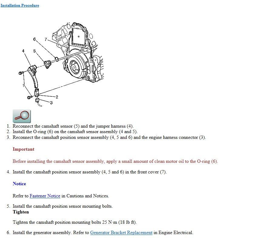

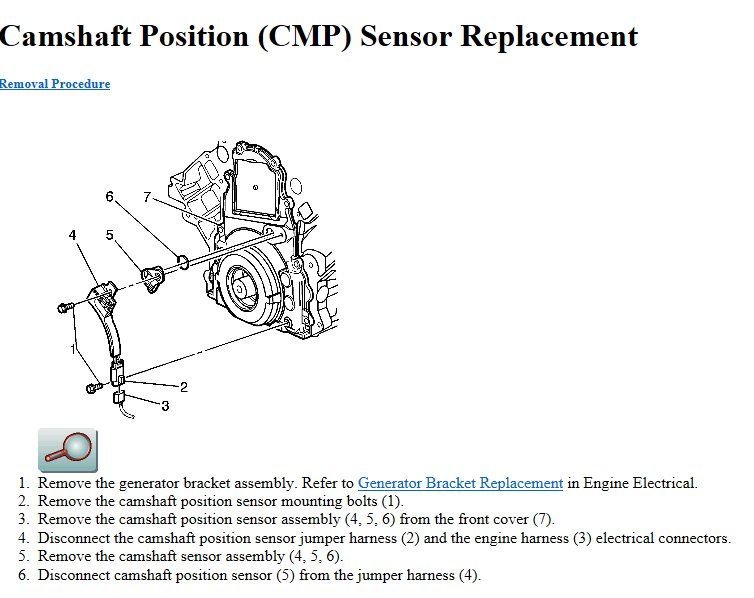

You will have to replace the camshaft position sensor, which has likely failed or the connector has come loose. Only then will you be able to clear the light. I had one fail on my Pontiac, and it didn't cause any issues for awhile, then it started to have issues turning over but not firing right away.
I replaced it, then all issues went away including the CEL

Are you hearing any tapping or strange sounds from the top of the motor? When you pull the sensor check for physical damage that would indicate a cam bolt backing out. Not unheard of even on stock ls2s.

thanks. Very helpful. I'll check for loose sensor bolts and harness. If the problem resurfaces or requires the timing cover to be removed I'll take it back to the speed shop.
