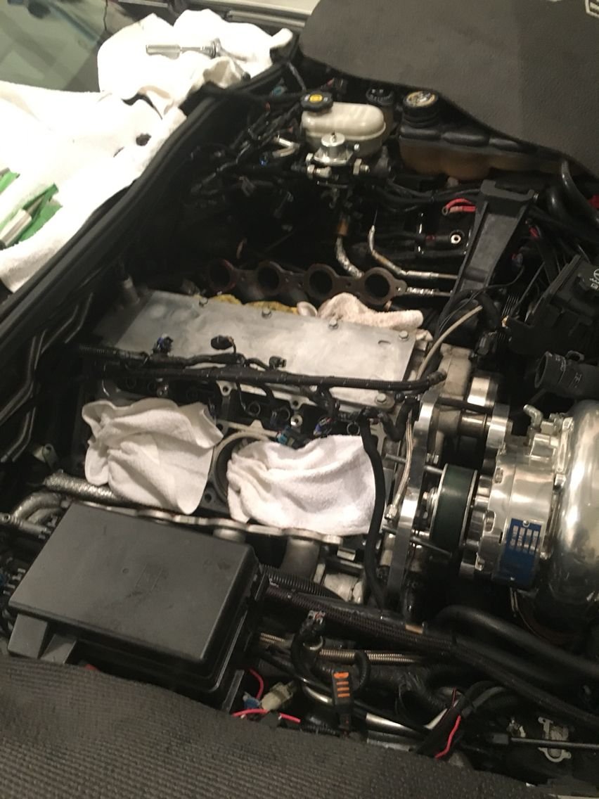

I assume I need to loosen the lower bolt first then the bolt behind the pulley? Do you have to use a special long handle wrench to get to the lower bolt? I tried to attach a picture. I can loosen the two upper bolts and I've removed the alternator.

Use whatever reaches to loosen it. If I remember right I didn't actually remove it. Just loosen it all the way so that you can move the bracket away from the head.

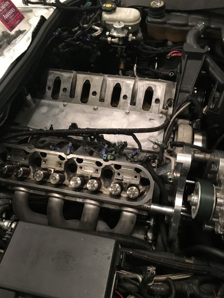

Whatever is easier I guess. My heads are off right now, and as you can see, I just loosened that alternator bracket. It only has to move a little bit to the front to allow the head to come off. I like to do as little as possible.
