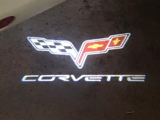

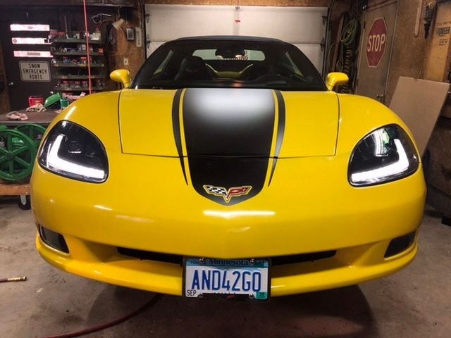

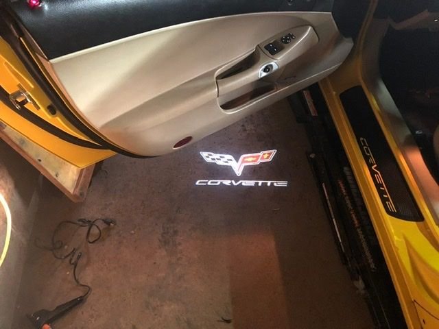

After I changed the oil, installed new Morimoto headlights, and projector ghost lights in the doors of my ‘06 and wired them to the interior lights under the dash at the at the floor, this problem started.
I would get in the car, try to start it, and I would get the “NO FOB DETECTED” message on the DIC. I read ALL the forums, replaced good fob batteries (car battery 2 years old), reprogrammed the fobs, all the “tricks”, and was about to try the more expensive fixes before breaking down and taking it to a dealer.
Then after more playing around, began to notice a pattern. I could press the start button many times, even with the fob inside the glovebox slot, and all I’d get is the same message and hear relays clicking... until the interior lights faded out completely, then VOILA! The car would start. Same thing when getting out of the car and trying to open the trunk, nothing until the lights went off, then the trunk would pop. Tire pressure sensors quit reporting actual pressure entirely too, 3 tires displayed zero always.
I disconnected the positive wires to the ghost lights from under the dash where they were connected and everything immediately went back to normal, including tire sensors.
There is certainly some kind of electrical interference with the sensitive circuitry of the wireless fob ignition system. Too much current draw? The lights looked great too! Too bad, at least they weren’t very expensive.
However, I’m pretty confident I could’ve paid LOTS of money to the dealer’s repair shop with them billing for lots of hours, and replacement parts before finally giving up and I’d still be stuck with the problem. I’m glad I figured this out for myself first!!
Who woulda thunk all this just from installing lights?!!
