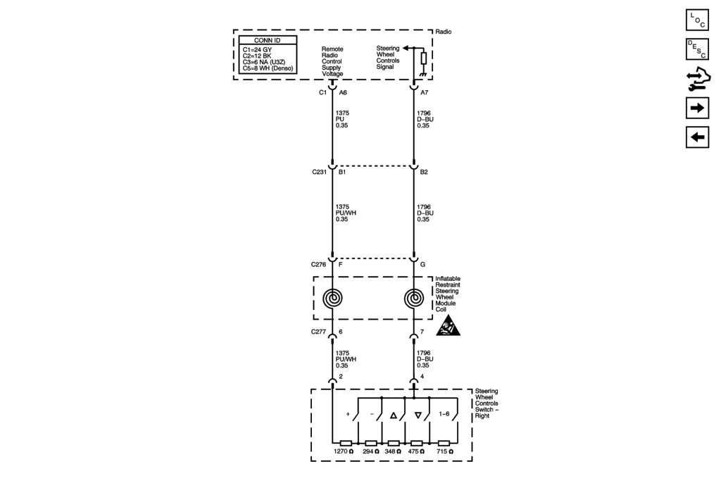

Hi, Dave. I'm looking for this but the left button array (Bluetooth control). Thank you

If you can't find it let me know, I can pop off my airbag and give you the color codes and the pin out to the clock spring if that will help you

Thank you sir. I have BT but I'm looking for some of the other info on the diagram.

Second diagram
http://www.revbase.com/BBBMotor/Wd/D...dPdf?id=166905

Thanks!
