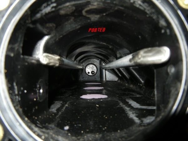

There metal bars that are installed inside the intake that redirect the airflow so they get to the plenum correctly, they don't look pretty but they are the really only proven LS3 intake manifold modifications that make real power. Pretty involved involved rivets metal and stuff.
Only 2 people do them. Rick Crawford & Gwatney.

I would like to see the LS3 intake with the rod treatment. If anyone has a pic, please post

Old Jan 14, 2017 | 06:35 PM
Suns_PSD's Avatar
Suns_PSD
Joined: Oct 2012
Posts: 8,434
Likes: 411
From: Texas
