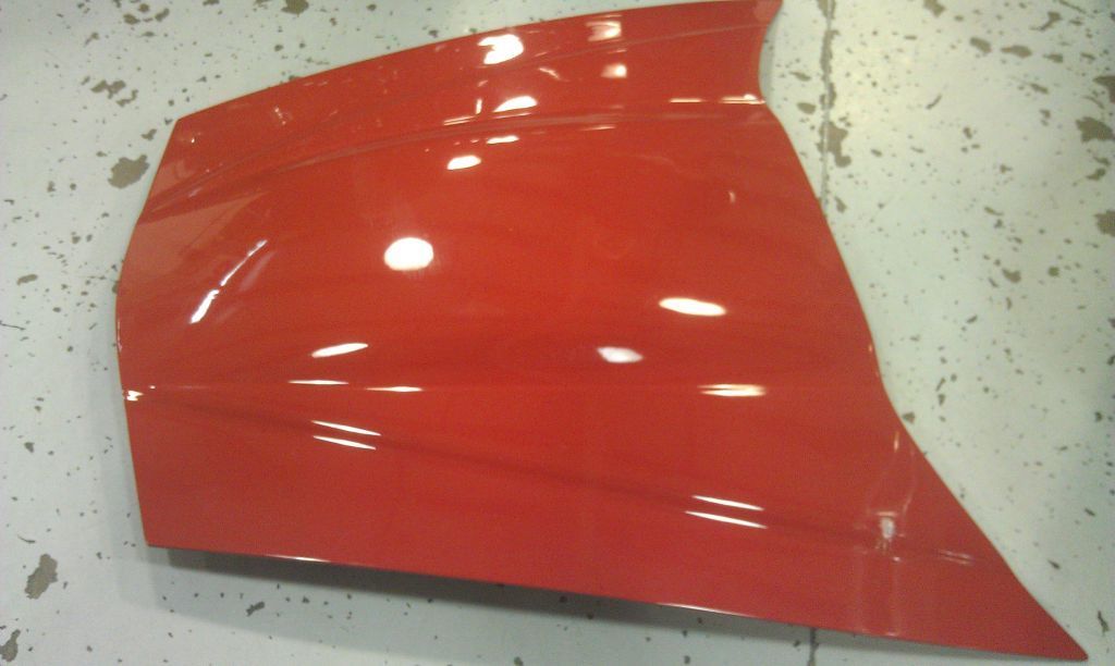

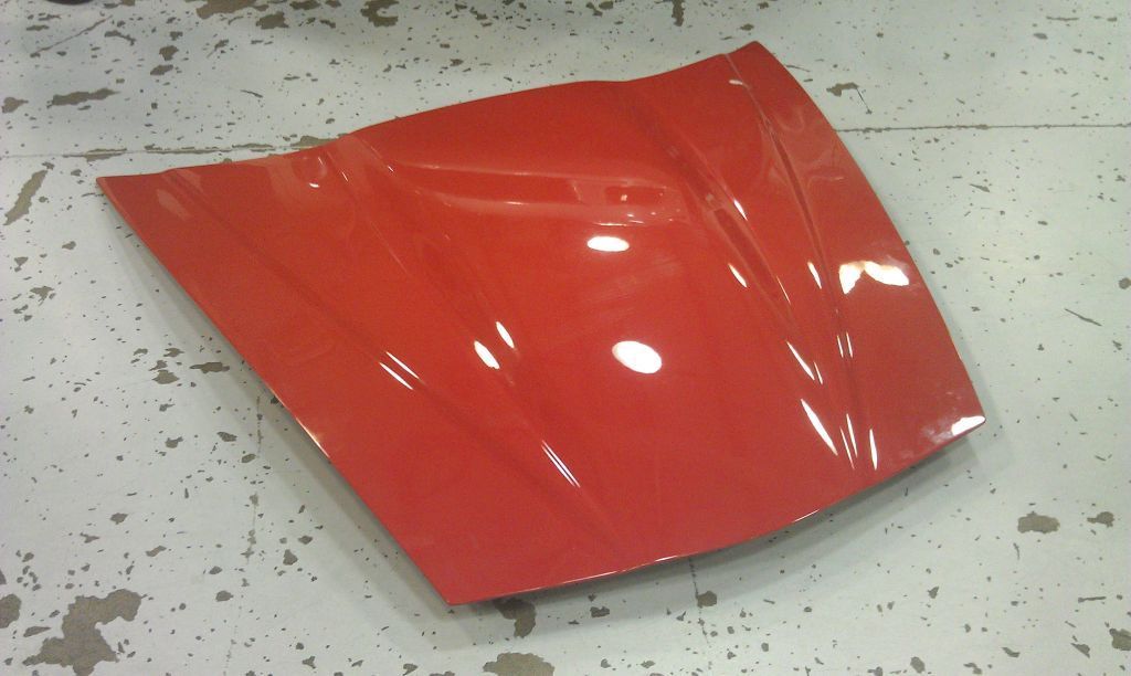

This is what one hood that clears the intercooler intake on a C6 looks like:
(sorry for the poor image quality - this is what I happened to find on our image server).
Old Jan 16, 2017 | 05:18 PM

Were there different versions of the intake then? The one I saw looked like no way it would clear the cowl. It didn't have that sloped rear.

For the Gen III/IV engines including the C6 fitments, no we only have two versions. One for the cathedral port heads and one for the rectangular port (LS3, LSA, LS9, L92...) heads.
For the Gen V engines we have made two versions - one with an intercooler brick the same size as used in the versions for the Gen III/IV engines. That product does not fit in a C7. We then made a version for the C7 with a smaller intercooler brick in order to fit it under the C7 hood. We have made over 1100 hp with the C7 manifold with very good post intercooler IAT temperatures and low pressure drops.
