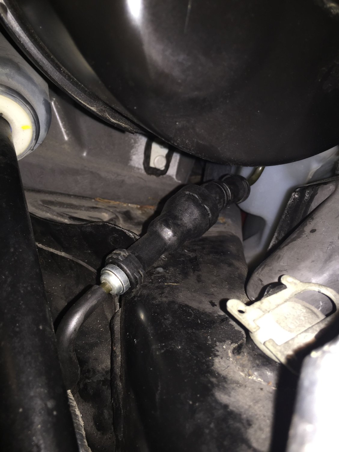

Alright. Happy to report I have found the problem. After inspection the rubber section of the line has developed a split. Oddly enough away from the side of the header.. so I suppose it may of gotten pinched or scratched up some how. Not sure how with the heat shielding around it but anyways.
I'm under the impression that the only way to change the entire line is to gain access to the inside of the bell housing. So the torque tube needs to come out right? Or am I missing a access panel somewhere??

Moving on. I'm having trouble reconnecting the plastic parts of the clutch line. It's hard to get enough leverage with my hand in the right spot. Anyone have any tips or tricks? Also something is causing the clutch pedal to stay stuck up all the way, it cannot be depressed. Any ideas? SMH this car...
PS I know the little u shaped ring is missing. I didn't want it to fall somewhere...

There was no way I was getting it in with the clip in place. The pedal by the way being stuck all the way up was part of the problem. I believe it had some sort of clog in the line because while it was stuck all the way up I COULD NOT push the valves together hard enough to clip them in.
I finally decided, after checking for anything obstructing the pedal, it may just need to be forced harder... so I pushed the pedal as hard as I could till it gave.. all operation of the pedal has been restored.
It was still all but impossible to snap the line together with the clip in place and the little clearance. I was able to force it together with the clip resting on the farthest edge of the cap... once all the way in I used my thumb to snap the clip in place.. all is well! Bleeding the clutch took a little while but I finally realized the pedal wasn't returning all the way up without me pulling it the last inch or 2.
I was able to bleed the system without using the bleed screw. It took a lot longer but I didn't feel like jacking the car up again. It honestly has more clutch pedal than before the line broke. I've drove it with zero issues.
