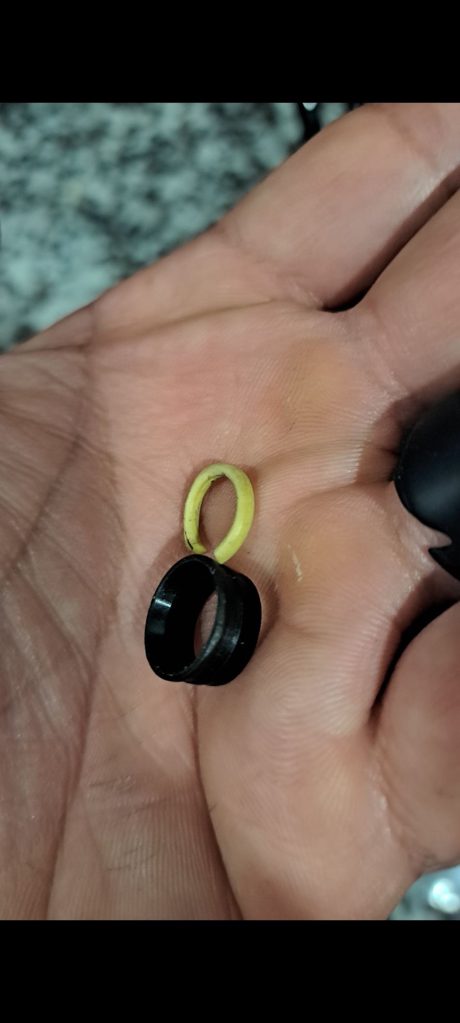

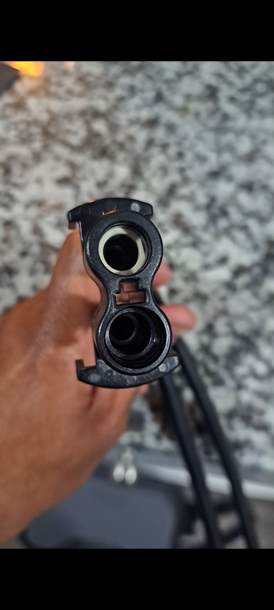

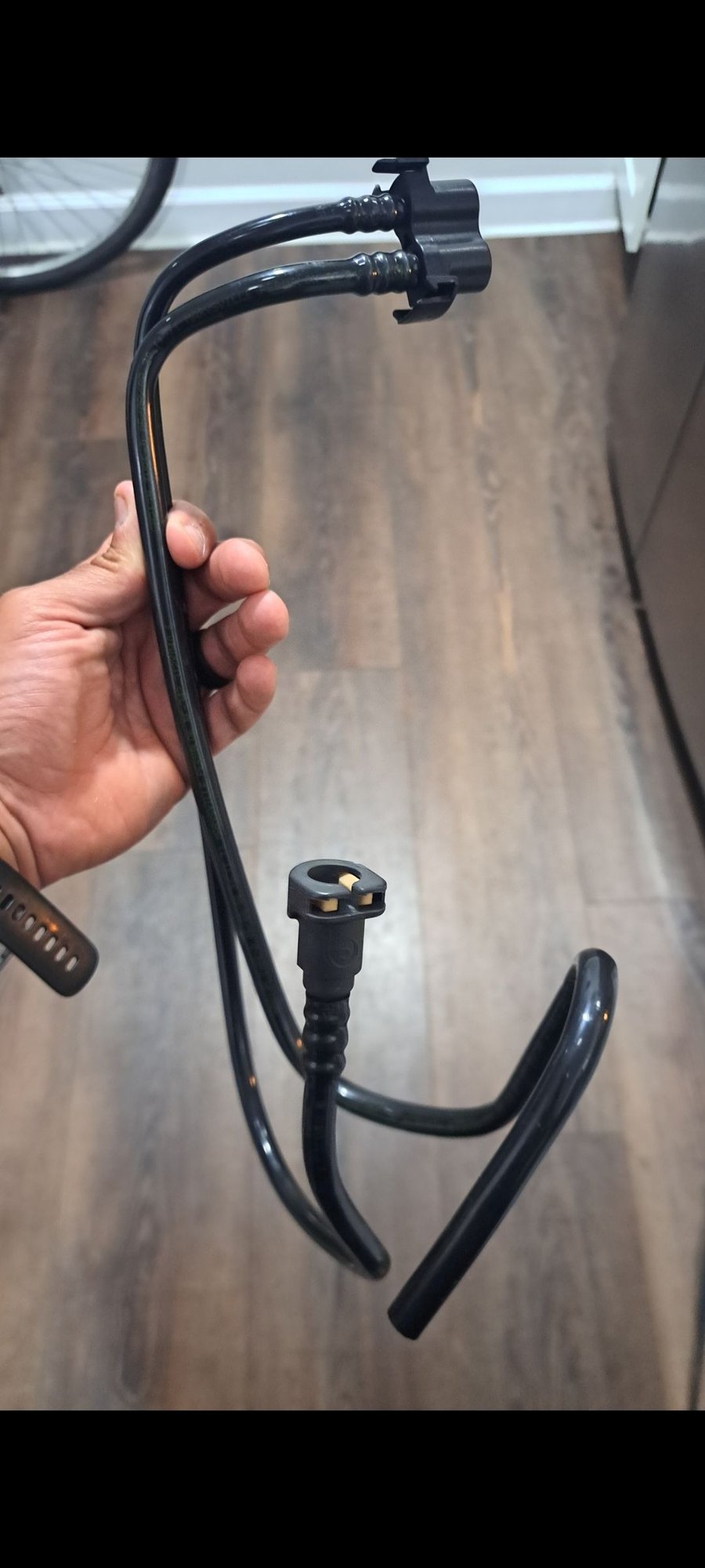

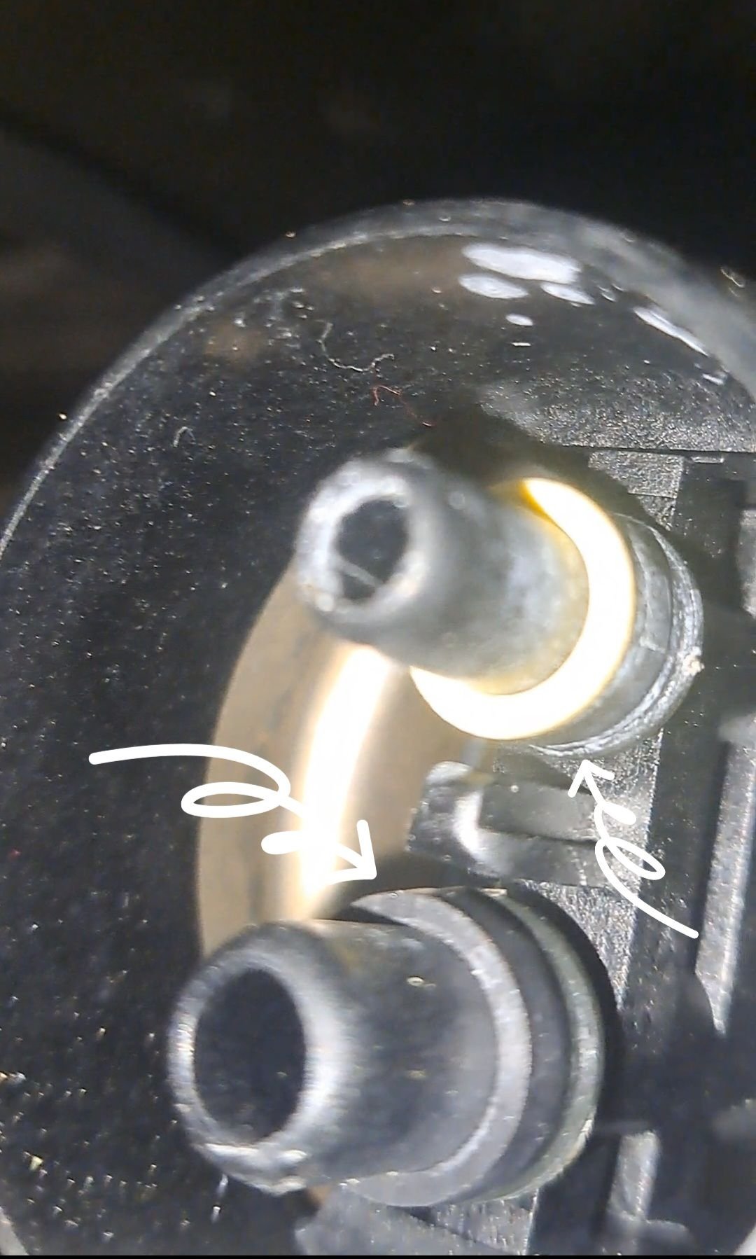

Im trying to make sure I get this reinstalled right the first time and I've seen some questions about this but not really an answer. During my battle to disconnect the crossover tube my lines were stuck together so I manged to get a long pick into separate the lines. When it came out I had a broken small yellow o-ring and the first picture of the male end of the crossover there are black plastic pieces. My question is are the black piece supposed to stay on the male side of the cross over when installing and do it need to replace that o-ring or did that just come lose from the female side of the fuel line and nothing is supposed to be on the male side? I have just ordered a new fuel line for the tank which is the last picture just making sure I dont need to have the black pieces and o-rings if they will be part of the new line I ordered. Thanks for the help in advance.

It has been a LONG time since I pulled those
But if I remember correctly I had the same thing happen but you basically need to put the o-rings back in place then the black cap will hold them there
