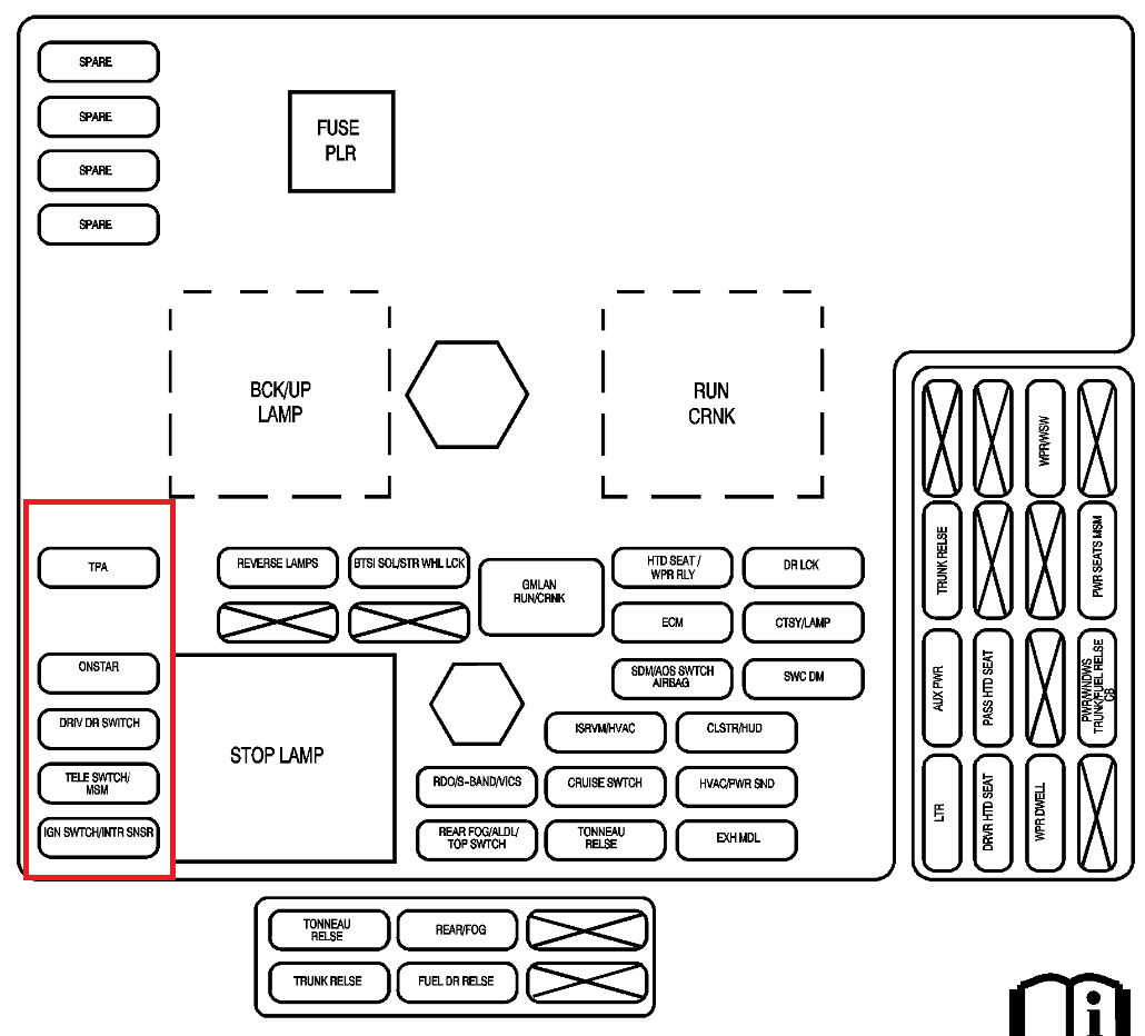

So I believe I found what was causing my battery to drain .5 volts in 24 hours of sitting. I did a parasitic load test and saw that my car was using about 140 milliamps when everything was powered off. Did some checking to see most common culprits and I heard about the BATT5 fuse. I pulled this and I got between 0 and 10 milliamps which is much more acceptable. Tomorrow (when there is more daylight), I will try to determine which connection from the BATT5 fuse is actually causing the drain.
It seems like the OnStar fuse is the most common one to cause this problem. I really don't want to have to pull this fuse because I like having bluetooth functionality. I actually bought a BT enabled VCIM to get bluetooth functionality. Would the only solution be to get rid of the OnStar fuse if this is the cause for my drain?

Frankie did you wait to take the readings for all systems to go to sleep before you took your readings It could take anywhere form 15 to 30 minutes .
You also might have an alternator problem ...if the readings are still high disconnect the alternator positive and take another reading

Remove the Bt enabled VCIM first. I bet that was your battery drain issue.

If you pulled Bat 5 and the draw went aways it is not the VCM
Plus your blue tooth has been installed for a while , you would have had problems before this
Here is a post from a forum member that tells us what batt 5 is .. looks like dash lites , courtesy lites etc .could the draw you were seeing come from the systems that were not completely asleep yet ?

It initially showed a 4 amp draw which I knew was outrageously high. After being connected for a minute it calmed down to .14 amps. I would say a minute or two after being connected. It did this every time I tried to test. Then once I disconnected the BATT5 fuse it went from 4 amps all the way to 0.00 to 0.01 amps.
Anyways, I couldn't let it go so I decided to head outside with a flashlight and pull the OnStar fuse. I still got a .14 amp reading so it has to be something else . I'm just glad its not the OnStar fuse. I will check the other 4 or 5 fuses tomorrow.
EDIT: Just saw your edit. I did wait about 30 minutes after unhooking the negative post on the battery before I did my testing. Just now, I waited just over 20 minutes.
Here are the fuses controlled by BATT5 which are located in the passenger footwell. BATT5 also controls the BCM but I am unsure where that fuse is. Is that within the BATT5 fuse? (also check out page 13 on this document):
http://www.costartech.com/pb/Vehicle...02005-fuse.pdf
Ignition fuse is interesting for my situation....

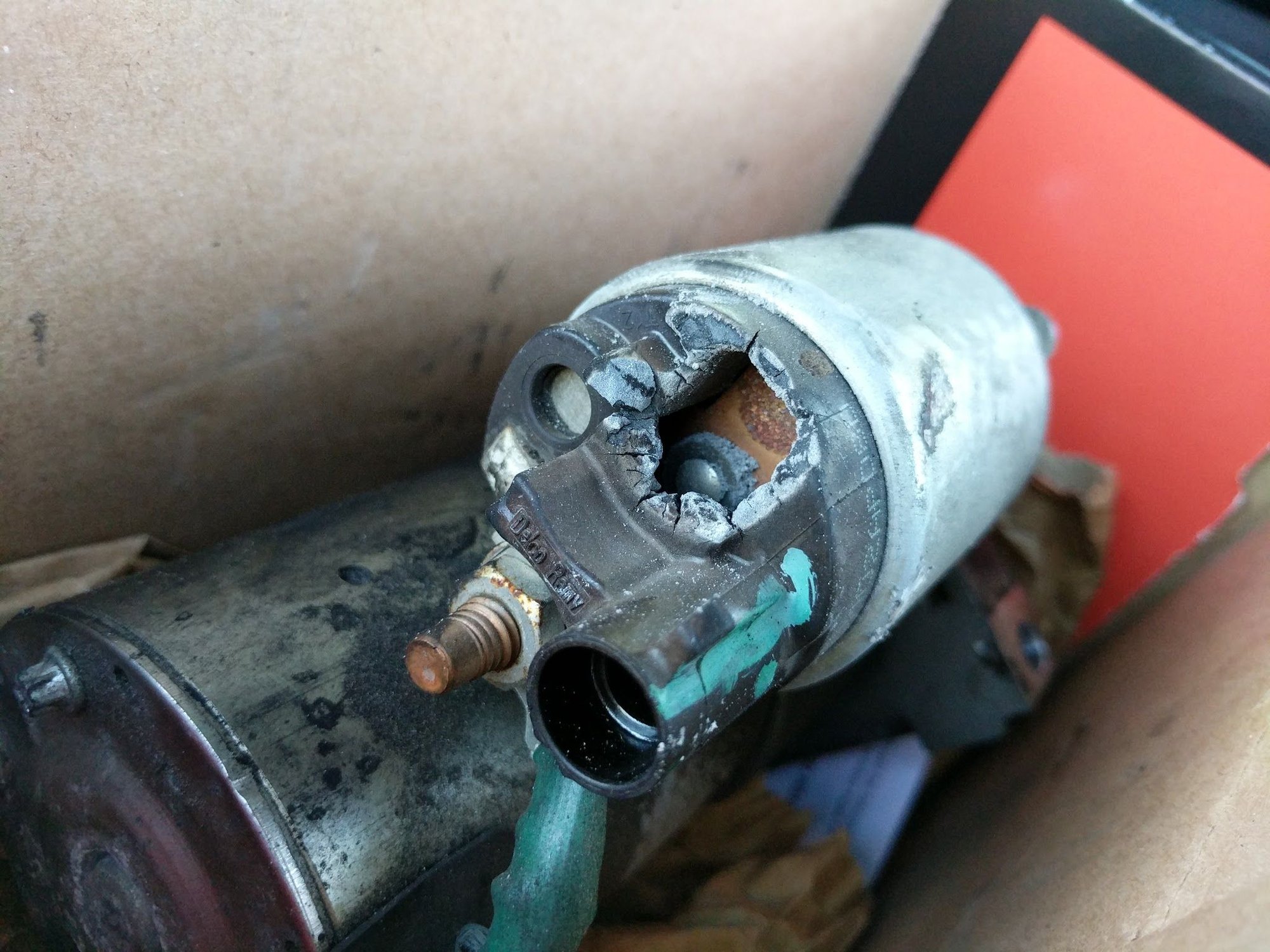

It was definitely the starter/starter solenoid. New starter is installed. He told me the lug was nearly completely torn off. I will get a picture of it when I get home. Leaving now to go pick her up.
Again, thank you to everyone in this thread who helped me. I really do appreciate it. I can't wait to get back and starting properly.

Here is that beautiful solenoid. Just like all the other pictures:

I'd say that might have been the problem

Wow cant believe that it started ....glad that you have it fixed
