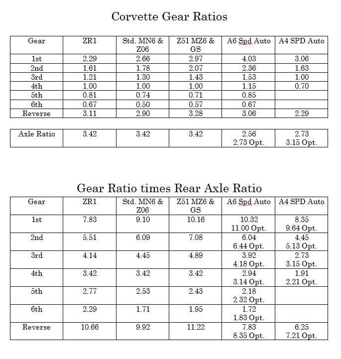

Here are the gear ratios for a C6 A6 , you will see that the A6 is pretty steep already ...........

When I ordered my '08, I didn't know the 2.73 was a stand-alone option on a F55 car. I thought it was only available as part of the Z51 option. A month after I took delivery, I was investigating a gear swap. Fortunately, after the first few track events, I recognized I could finish the 1/4 mile at the high end of 3rd gear with the 2.56 rear. The 2.73 would have required a shift to 4th and crossed the finish a lot lower in the power band.
Now a 3.42 gear with the A6 will cross the stripe at the high end of 4th and the ET gain is about .10 sec. The downside is the ~$1500-2000 upfront cost for the swap and the ~9% higher fuel costs on the long term.
