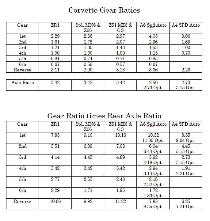

Not worth the time , effort and expense
here are the gear ratios with rear end figured in (look at the 2nd column from the right in the second chart below )
Dave
