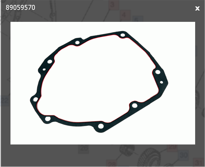

I've got an '05 6 speed manual that is leaking fluid and I'm pretty sure it's a gasket. Problem is, I can't find a gasket kit anywhere. I can't even figure out what model of transmission it is. Everything I find is for a C5.
Can anyone help me out and tell me what model of transmission is in the C6 and where I might find a gasket set?

Should be a Tremec T56. RPM Transmissions in Illionois has been mentioned many times on this site.

It's a T56 transmission. The case does not use gaskets for assembly, the mating surfaces are sealed with silicone. Are the drain/fill plugs tight?

actually there is a gasket on one end, the other end is rtv silicone as you said. I would also check the back up switch, it can leak as well

Thanks for the info, I had a hard time finding it because most Google searches don't show it with a axel attached.
Anywho, I'm still working on getting it out, but I believe it's either the rear gasket towards the back of the transmission, or possible on top. Looks like there is a wire or cable going into a small rectangular box on the top side, this is what I am suspecting is the culprit. I won't know for sure until I get it out.
