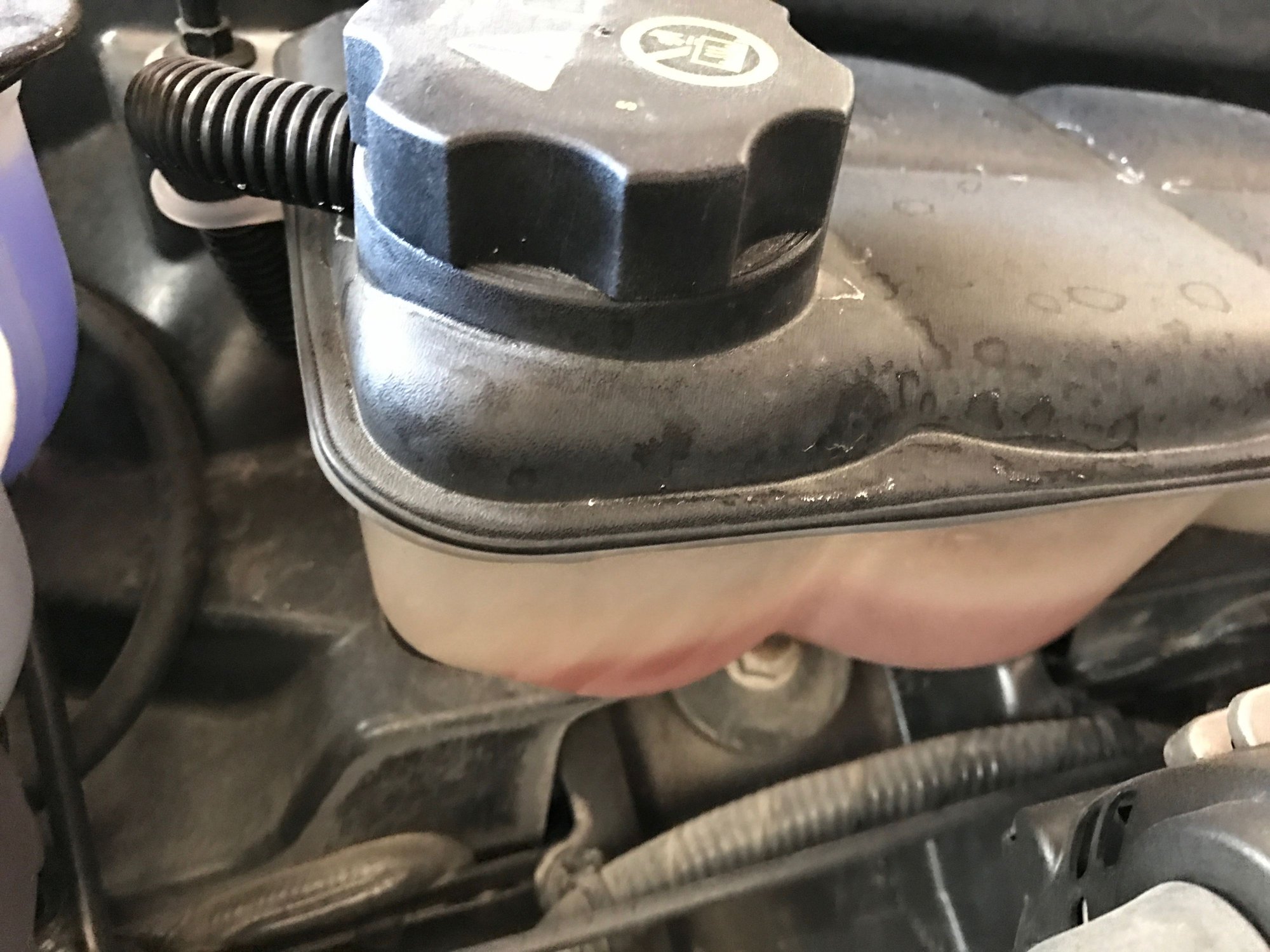

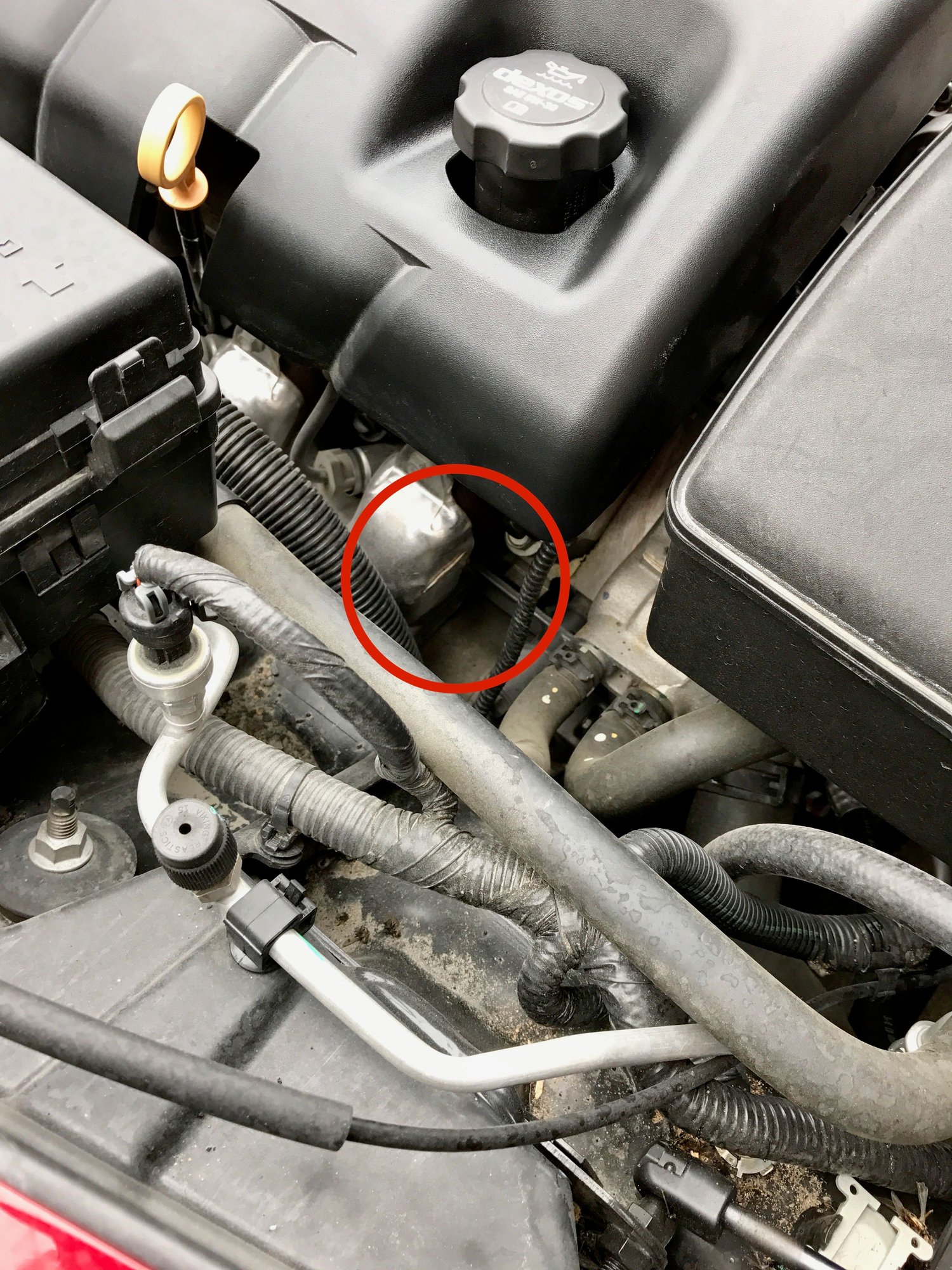

I let the car sit overnight with a piece of cardboard under the engine. No drips while sitting showed up. Started it up this evening and again saw the smoke and drips on the cardboard
Here are two photos one that shows the pink coolant in the tank and the second that shows the location where the light whiff of smoke comes out under the exhaust header. I would have thought if it were the water pump I'd see drips under the water pump but not smoke coming up where I put the circle.

Just a shade tree here and don't know hoses in that area. I would be concerned that head gasket to the blown to outside the problem.
Have you checked oil for water?
And the water does look pink, but mine is orange in color.

Yeah, coolant is orange. Power steering and transmission fluid could be red though. Or maybe it actually is coolant after all.

Stopped by my local Chevy dealer and spoke with one of the mechanics who's worked on their 6.2L engines, not Corvettes. Said it's not uncommon for a car sitting for six months, 4 years of winter storage, to have this. I showed him the photos I took and described what I saw/smelled. He said that they’ve had a few of the 6.2L engine water pumps where the seals flatten out under the shaft and it takes getting up to temp to reform and seal again. He suggests let the engine fully reach operating temperature and then see if there is any seepage or smoke coming out.
He confirmed that GM puts in pink Dex-Cool from factory, even showed me a 2017 Silverado in the shop with same looking color in overflow tank.
So I’m going to give that a shot tonight and see what happens. Nothing to lose in trying it at this point.

Well folks, I checked underneath and no indication of any drips and I looked around the engine where we had seen the light smoke and there was no indication of anything. Started it up, got the oil temp up and then drove it around town, what a wonderful feeling after a long winter, till the oil temp was over 200. Came back, parked and let it run, still no drips.
Hoping it was just the pump needing to reseat the gasket after the cold winter. Will certainly keep a close eye on the coolant level.
I feel like the boy who cried wolf but having my son-in-law see the smoke and fluid means I'm not as senile as some think. Thanks for all the suggestions. The good news is I've added a flexible mirror with LED lights to my tool box.
