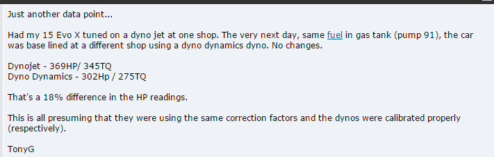

saw this on another site, shows numbers from a Dynamics dyno and dynojet... sounds like the dynamics reads low. i had my old car dyno'd on a mustang dyno and those, around here, are also known as heartbreakers

There is a dyno jet in my area that reads just as low as a local mustang dyno. Just use the same dyno everytime.
