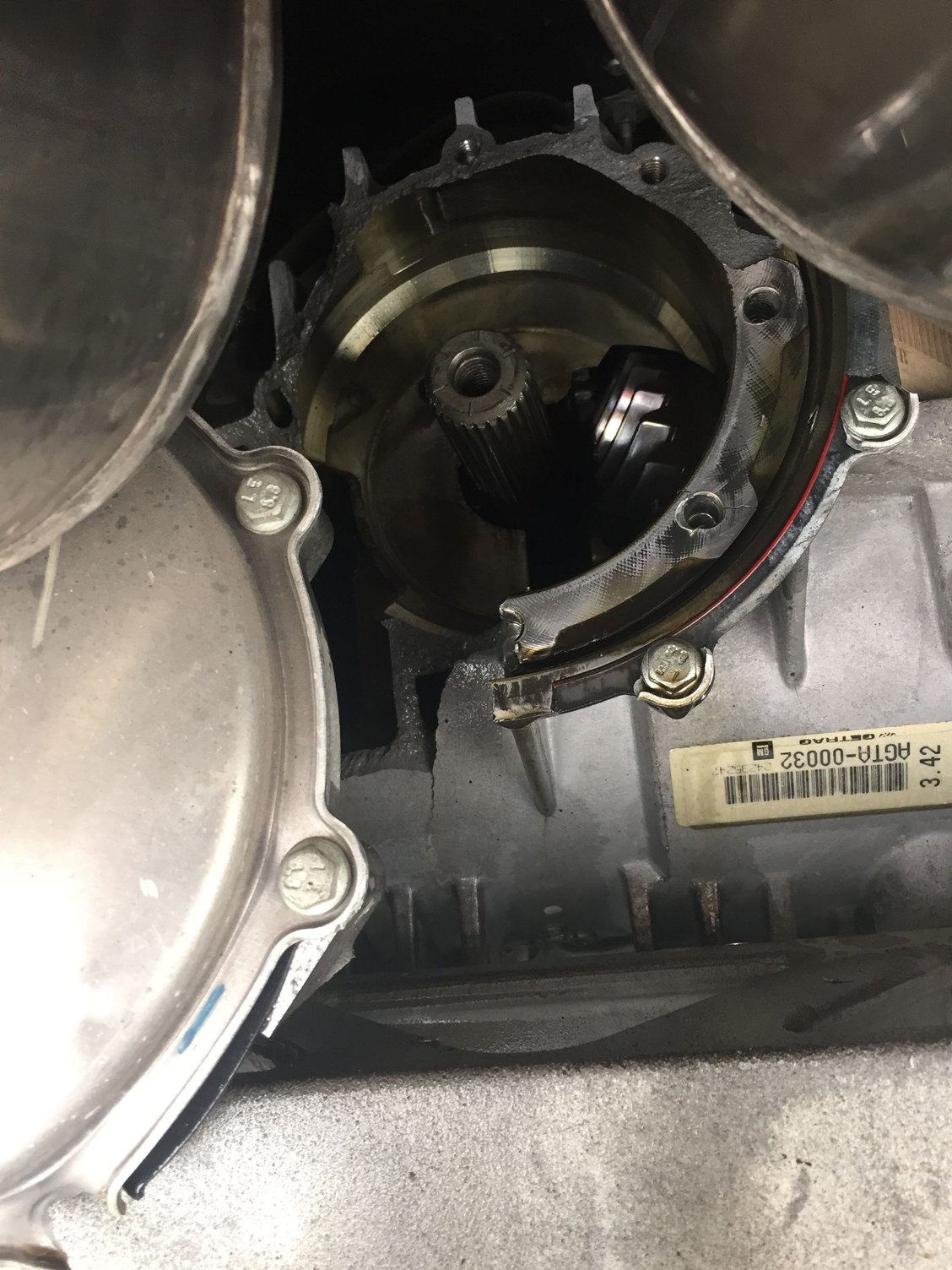

Picture taken after put on trailer

https://www.corvetteforum.com/forums/c6-corvette-general-discussion/3337970-2005-c6-rear-end-differential-failures.html
seems like it's not a giant problem def something to worry about, seems like as long as your careful about it and not making monster power you'll be fine. Gonna run 555r nitto drags
