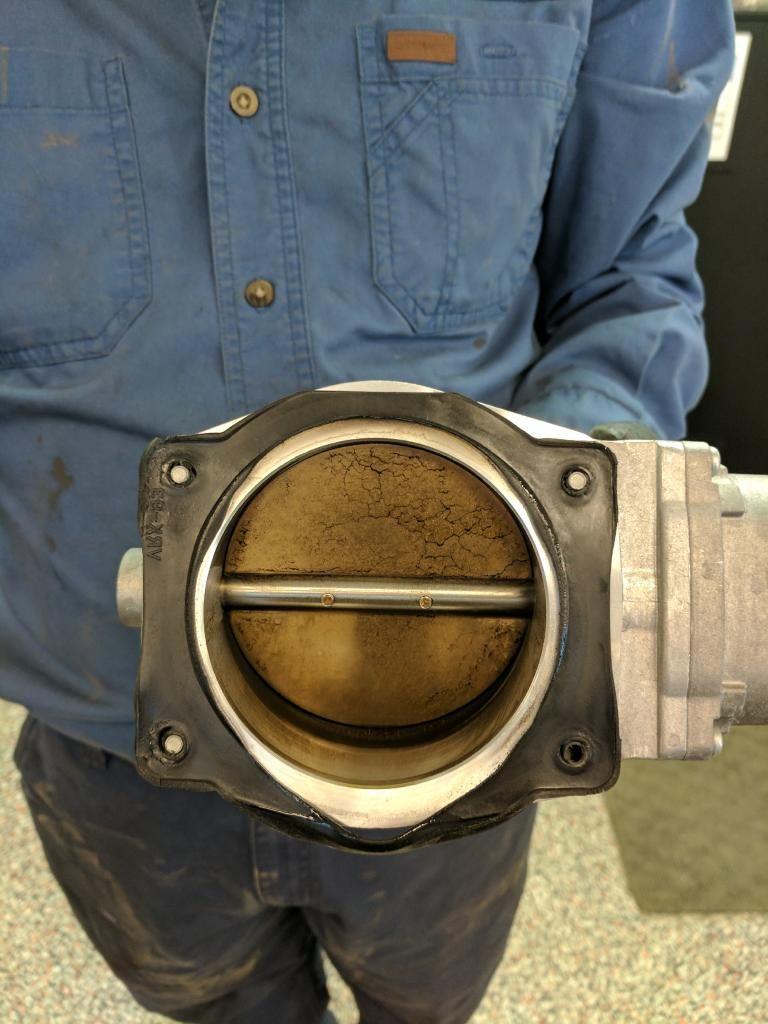

Well my mechanic found the source of the vacuum leak and it was unrelated to the installation of the engine mounts. The Vararam Power Wedge TB Spacer I've had for a few years literally melted causing a good sized vacuum leak.
Still trying to chase down the communication codes. The wiring harness to the steering rack appears to be un-damaged.
