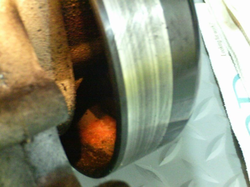

By passing the leak test, what was the starting pressure and end pressure over what period of time.
The reason I ask, I had a similar experience, losing some coolant, no drips etc. Pressure test did not show anything substantial. A few months later, I noticed a bit coolant on the belt pulleys, but no sign of anything leaking. I tightened and checked every hose clamp, and some were a bit loose, but none leaking.
I did another pressure test, left it on for 24 hrs, noticed a definite drop in pressure, and finally, a small stream of coolant coming from the pump pulley. I changed out the pump...no further issues.
I figure that if the pump pulley stopped in a certain position, it may not of leaked by the seal. If it stopped at a point where it leaked past the seal, the coolant would drip on the hot pulley or engine and either gel up, or evaporate.
Here is what the back of the pulley looked like after I replaced the pump with a new one. Notice the caked on coolant on the inside of the pulley. The problem is that it'a almost impossible to see back there with the water pump installed. maybe a mirror.
