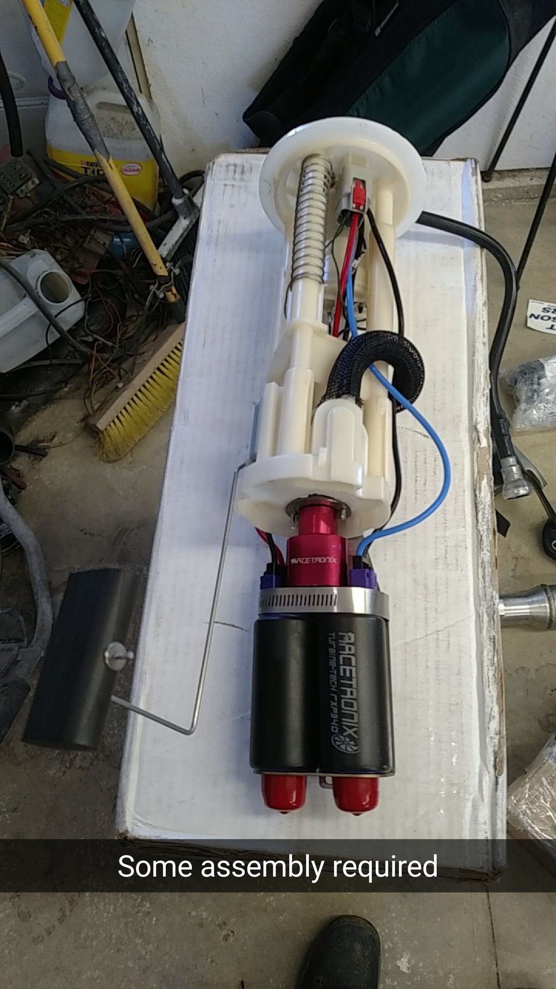

2 x Racetronix RXP340M Turbine-Tech pumps here... some assembly required
