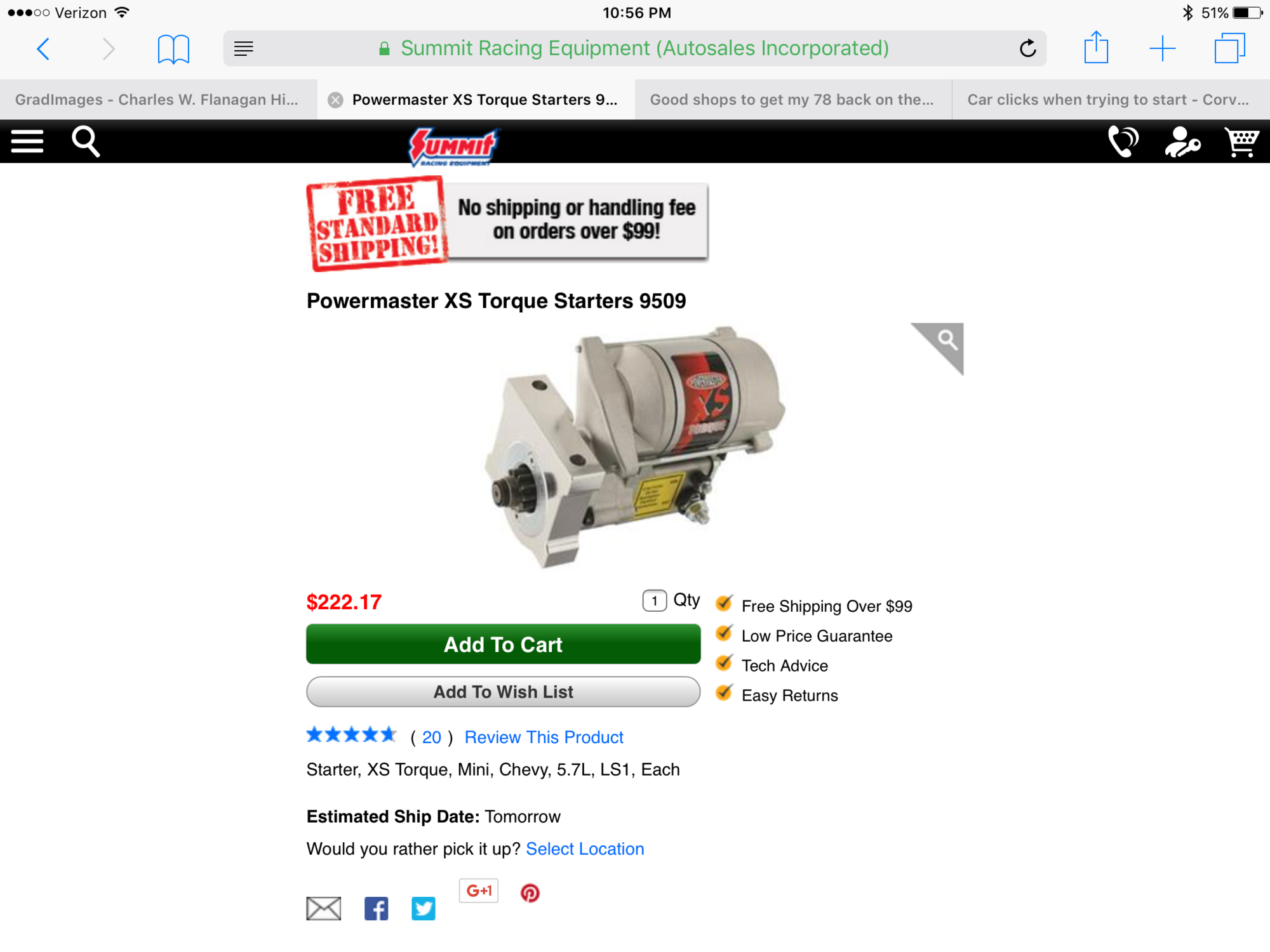

Put this starter in .will be last starter you will ever need.have to clock it a little and put on a connector .
says it doesn't fit 07x
