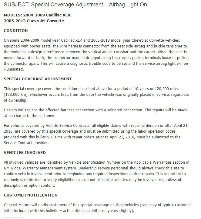

If you dare visit a GM service department, there is a special coverage adjustment from GM on the connector under the driver seat.
The only problem with the fix is that cut away the connector and solder the wires together. It then makes it a real PIA if you ever want to remove your seat from the car for whatever reason.
