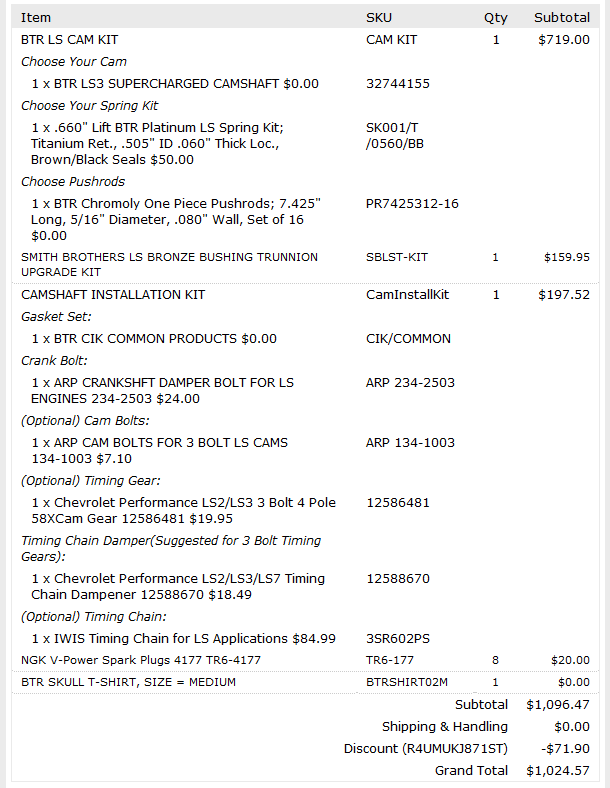

here you go.. I already have a 25% underdrive & some other things or they would have been purchased from BTR too
Also got a Mcleod RST clutch & steel flywheel to replace the old Mantic. And a crank pin kit from ECS.
