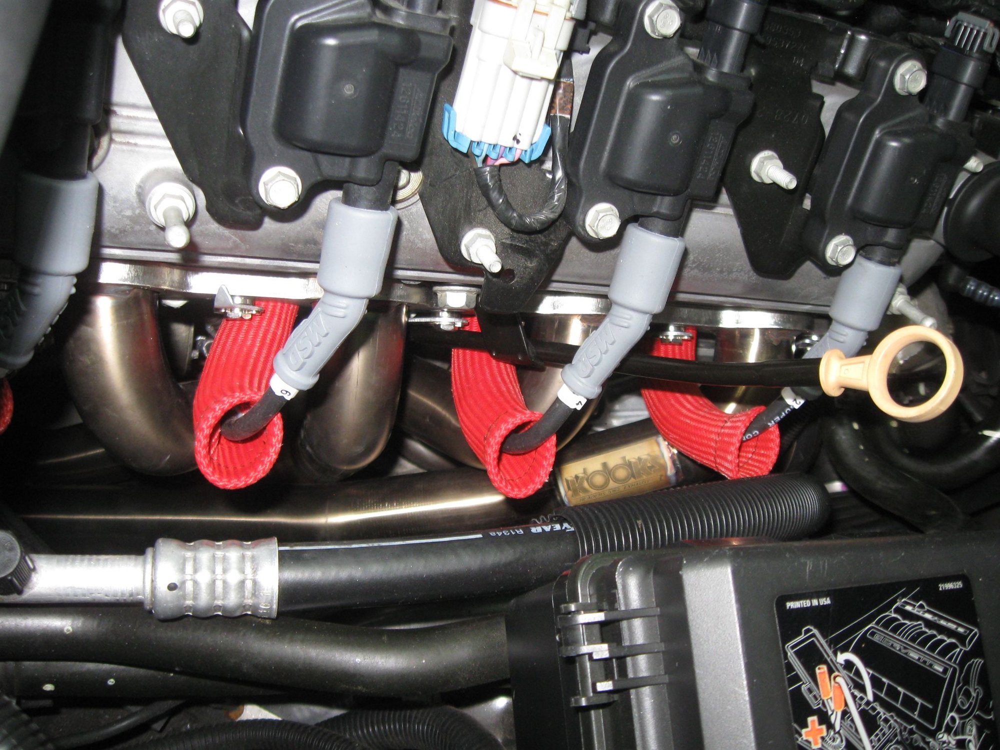

About to install Kooks 1 7/8 headers in my 2010 GS. I know certain headers are better about clearances than others but just wondering if anyone has had any luck with any spark plug wires NOT touching the headers? Looking at the taylors or msd's and wasn't sure if I should get straight or angled plug boots. Any advice would be awesome! Thanks everyone!

I have Kooks headers on my LS7. One plug wire boot is close to the header, so I twisted the wire at the coil just a bit to pull it away from the header. As long as there is an air gap you'll be just fine.

OEM. Just had to adjust the wires where they wont touch.

Just did the Kooks 1 3/4" with MSD wires and DEI red boots, I see no problems

I run Kooks 2" and 1) they dropped in like a glove literally with no banging, cursing, bleeding knuckles nothing and 2) I have MSD wires with no issues.
As someone mentioned above I just tilted the boot as necessary and have had zero issues. I personally don't think you need wire condoms unless you just want the dressed look.

These weren't cheap but they fit great and I wanted to do overkill on the heat shielding:
Amazon Amazon
I also went with these boots for even more shielding:
Amazon Amazon
Both fit great and other than a little burning in of the heat shrink tubing on the wires I have had no issues. The heat shrink just smoked a little bit and shrunk some more, nothing abnormal. Definitely not the cheapest route but I am happy with them.
