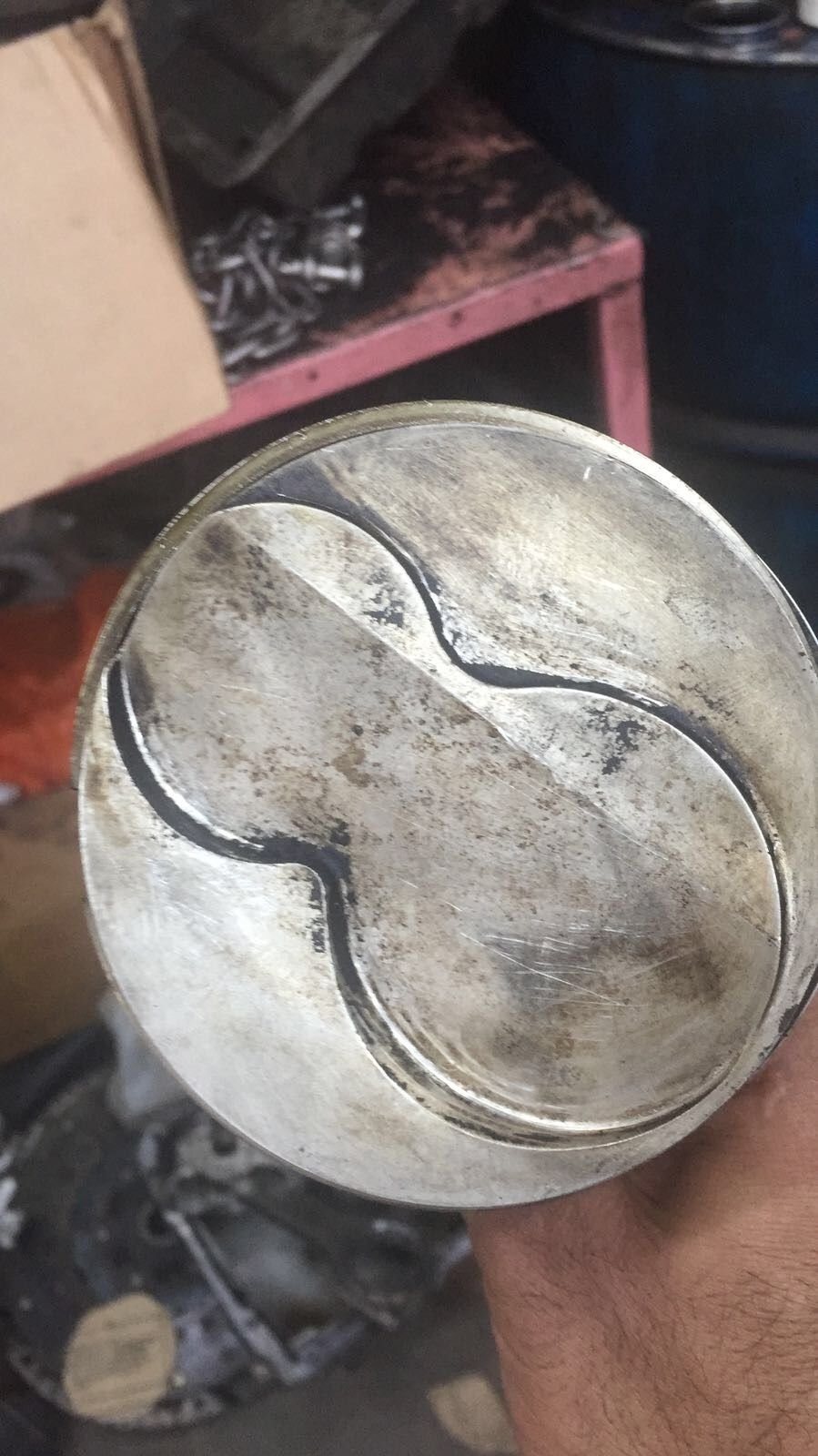

Hi,

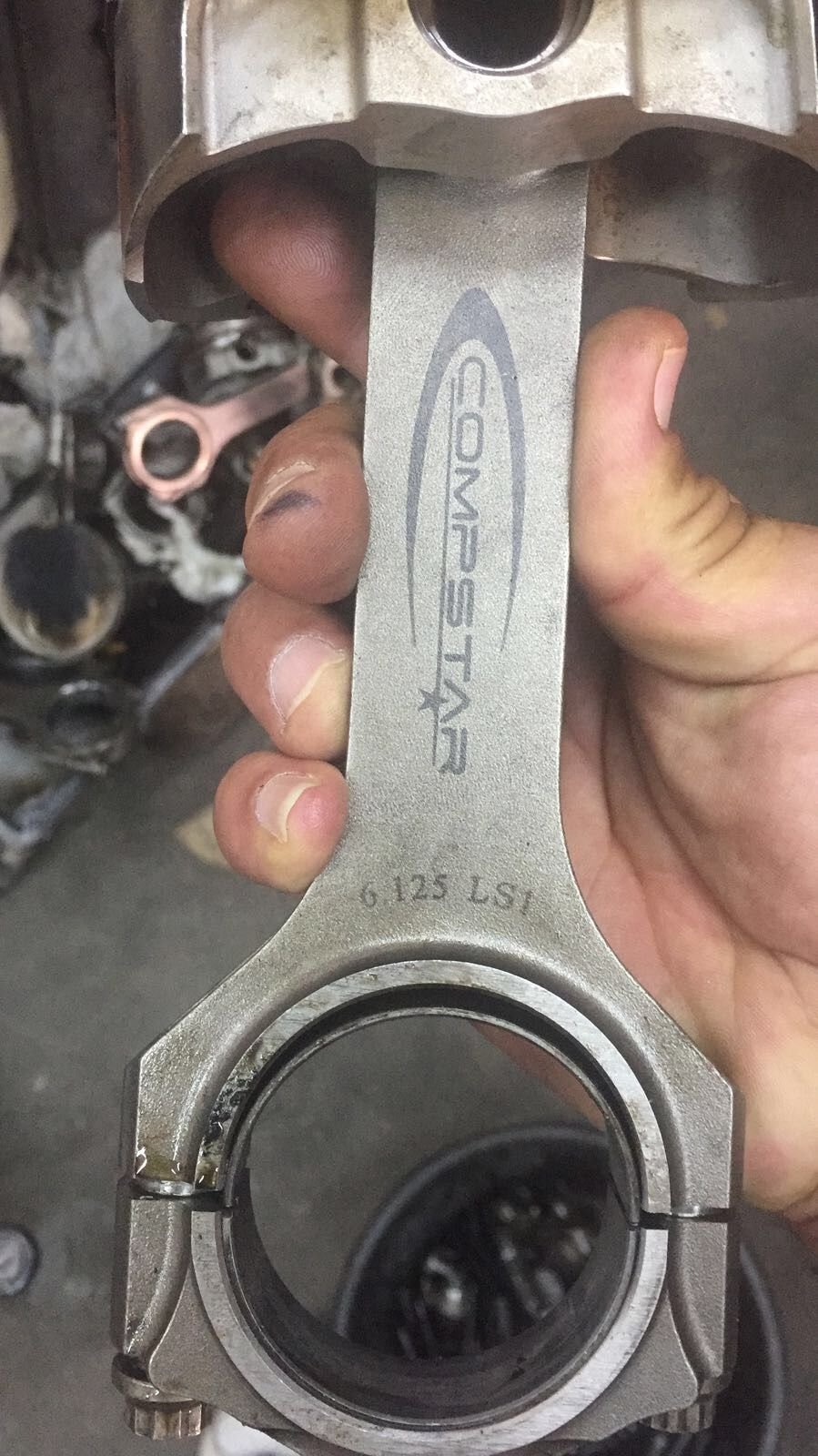

a couple of days ago bought an LS7 off of a Camaro. Thinking that it was an original. I got the full engine, but no alt., comp., water or power pumps, for $4,500. I live in Kuwait by the way. We open up the engine and the picture below show the internals.

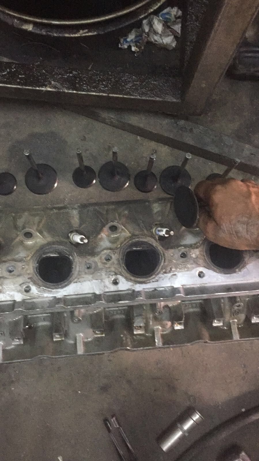

heads seem to be correct GM12578449, some of the valves had caps, but the springs were replaced with double springs for the cam (LS7-GY21). The block is 7.0L, but the rest are not correct for an LS7!
so, I'm returning the engine today, but the guy is asking to reduce the price to $3,300!
is it worth it, I'm guessing not!!

What are your goals? Is this a good engine and you are just freshening it up? Does the block have stock sleeves?
What crank is in it?

- I want an LS7 to install on a 78 Trans Am or a 69 Camaro.
- Don't know if it's a good engine, bought it from the scrap yard, but we opened it up and took it to the machine shop, it looks clean except for the cam which seems to be worn out.
- Block has stock sleeves.
- not sure about the crank.

The only valves that should have caps are the intake, as they're titanium.
Find a new cam that will work for your goals.
You should be able to tell pretty easily if the crank is stock or not.
So, if it's a 427 or a 454, or a 441, does it really make a difference? The idea is to install a really nice updated engine in your classic muscle car, right?

it would definitely won't matter to me if it's a 454 or 441, but I was worried about the quality and whether this setup would work with a stock cam and heads.
Also, I'm not sure how to distinguish between titanium or steel valves. Guessing I would replace all to SS valves maybe.

The intake valves are titanium. They are the bigger of the two. If you install them without the caps your engine will fail. The stock heads will likely need new valve guides. You will need to have a machine shop check them out. Most guys choose to recondition and reuse the intake valves. Ferrea exhaust valves (part F2042P) are a good idea to replace the stock exhaust side.
The stock head castings and cam will work with a stroker bottom end.

A magnet will stick to steel valves but won't stick to Ti valves.
