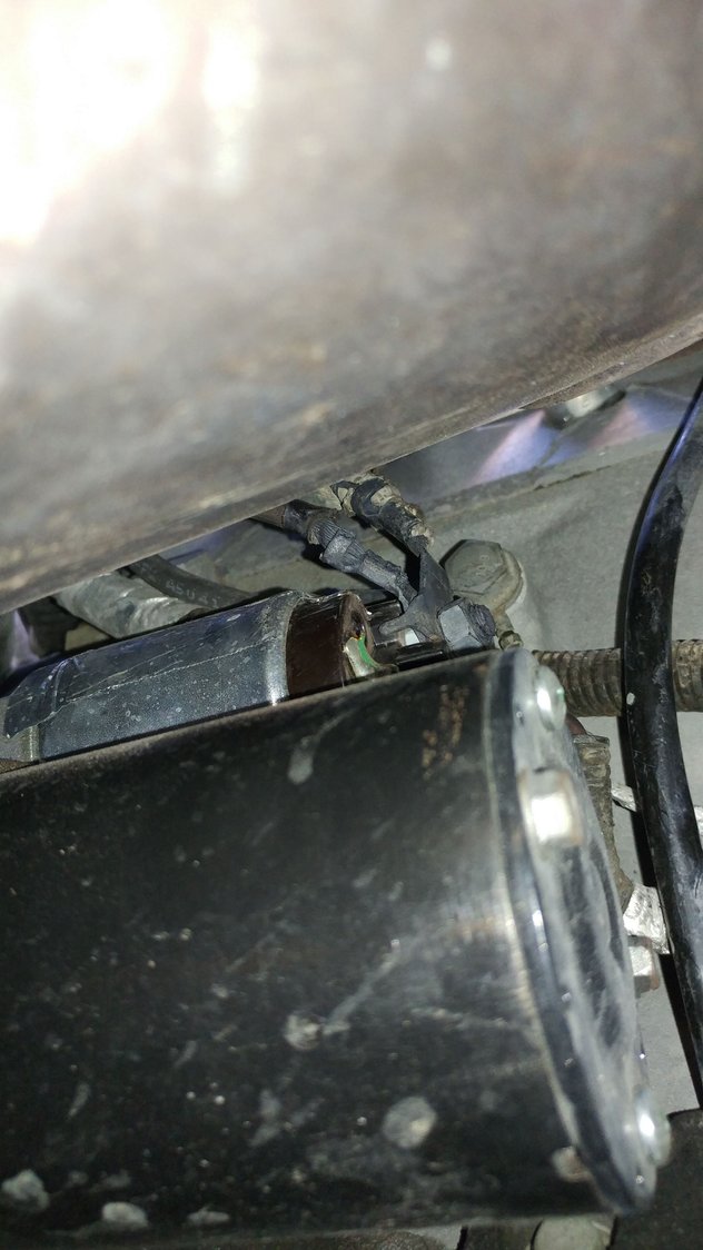

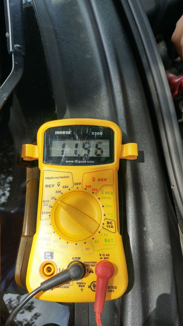

06 ls2, mn6 car. Battery voltage will drop out of nowhere. I helped my friend change the starter like 2 months ago, due to a bad solenoid connection. We got under the car, and the terminal is there, no cracks. This pic was with the engine running. Any ideas?

Check the voltage at the alternator, the large post. This should show about 14.8 volts while running. Double check that the wires are tight on the starter also and are clean.

Ok just looked at it from top of the passenger side engine. And I can see the terminal on the starter solenoid is bent/angled to the right.

Checked the battery with multi meter, and it's at 12.07
Checked the ground for the alternator and highest it read was 14.08
Thoughts? And yes, the solenoid post on starter is bent. Waiting for the car to cool down to get under it, and have a better look at the starter.

The post is bent. About to loosen the nuts to see if there any cracks on the solenoid post.

Ok guys. I was able to wiggle the starter solenoid post by hand. Tells me I need to change it again? This time, I'll wrap it better.
