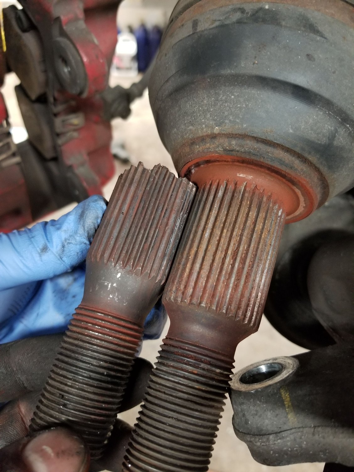

The 2009 and later axles have a 33 spline count (and is larger in diameter) on the end by the brake/hub so a C5 axle will not work as they are only 30 spline. The C6 2006-2008 axles are 30 spline on the brake end also. So if you have an 2009 and later you got to stick with the axles that are on car and can not do any C5 stuff.
For a visual here's my 09Z axle vs my buddy Joey's 06Z axle. Clearly beefed up
