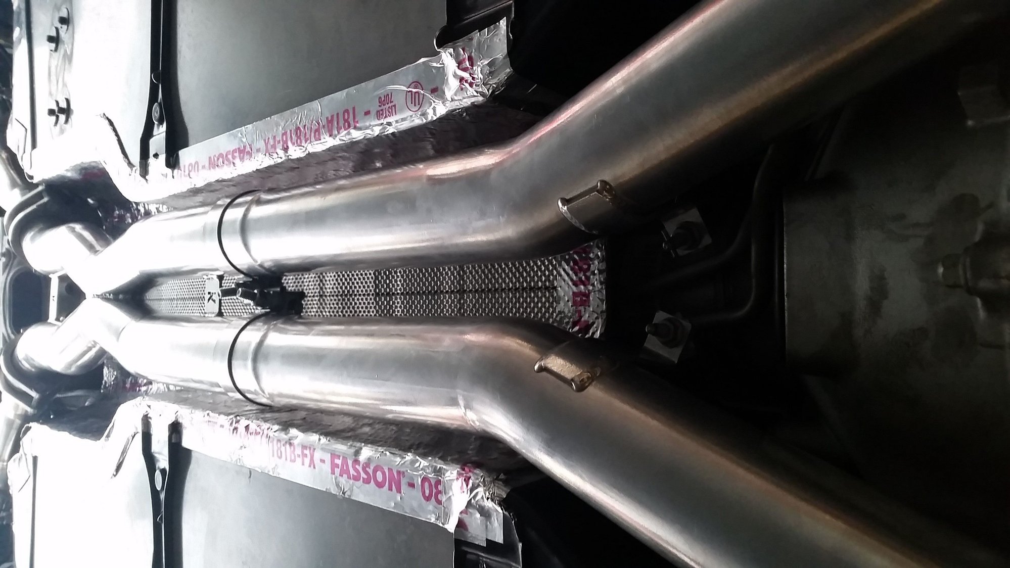

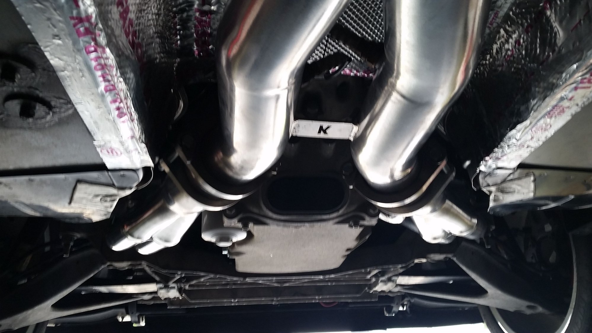

No SS, but you can see up tight and tidy. 11 G.S. Kooks and no catts

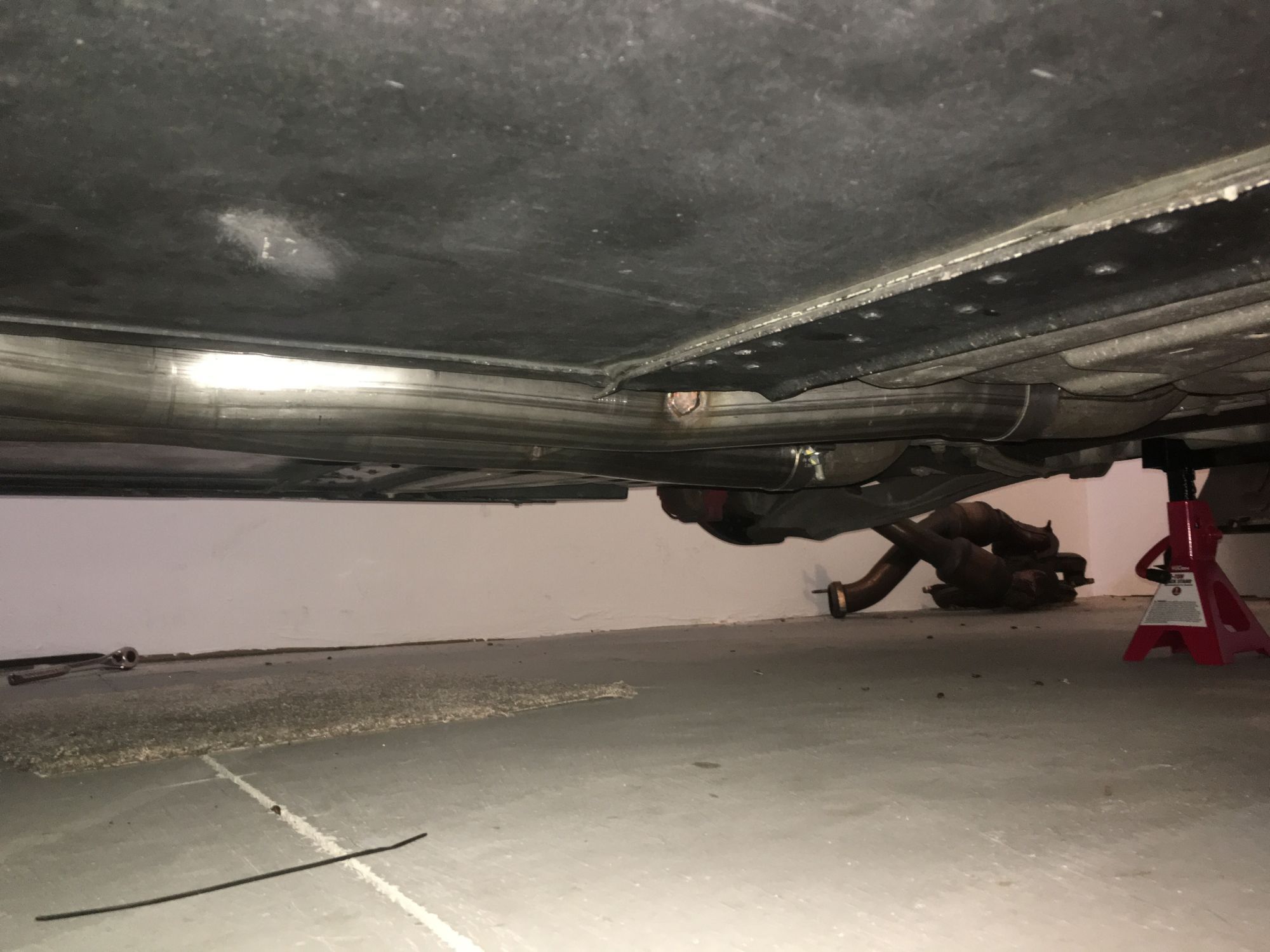

Here ya go:

Originally Posted by cstapp99
Here ya go:
Thanks for the pic! Yeah mine hang about that low if not a little lower.
Could you tell me what kind of heat shield material you used on the bottom side of tunnel and maybe a link to where you got it. I'm getting ready to install ARH headers on mine
Also have you had any problems getting the foil tape to hold in the heat.
I'm a home builder and we use that tape all the time but not sure how it would hold up to extreme heat.

Wiped down area W/ gasoline,then scrubbed down with DAWN dish soap. Blew dry and added time to dry totally on it's own.
Many products on the market, but I used a product called (Boom Mat). From internet says for both noise and heat. Very sticky and has stayed in place 1 1/2 years no sign of wear or looseness.
Coated pipes and mat has made a great difference to inside car heat. The foil tape is holding it's own and doing well. I did burnish the foil tape down very good. I would do the whole thing again if called on, .......no regrets

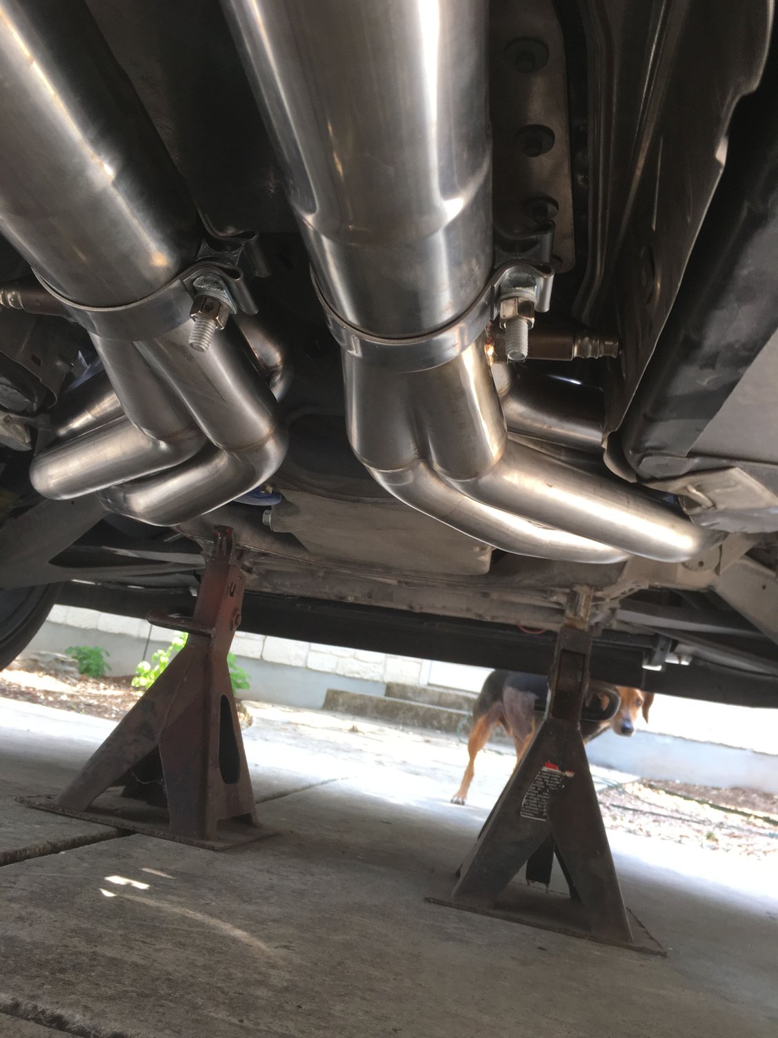

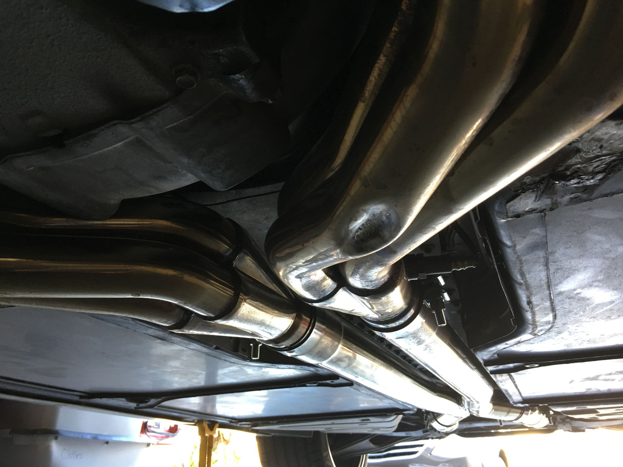

Default Here are mine
I used the alum. Sticky pad to reduce heat. It works great

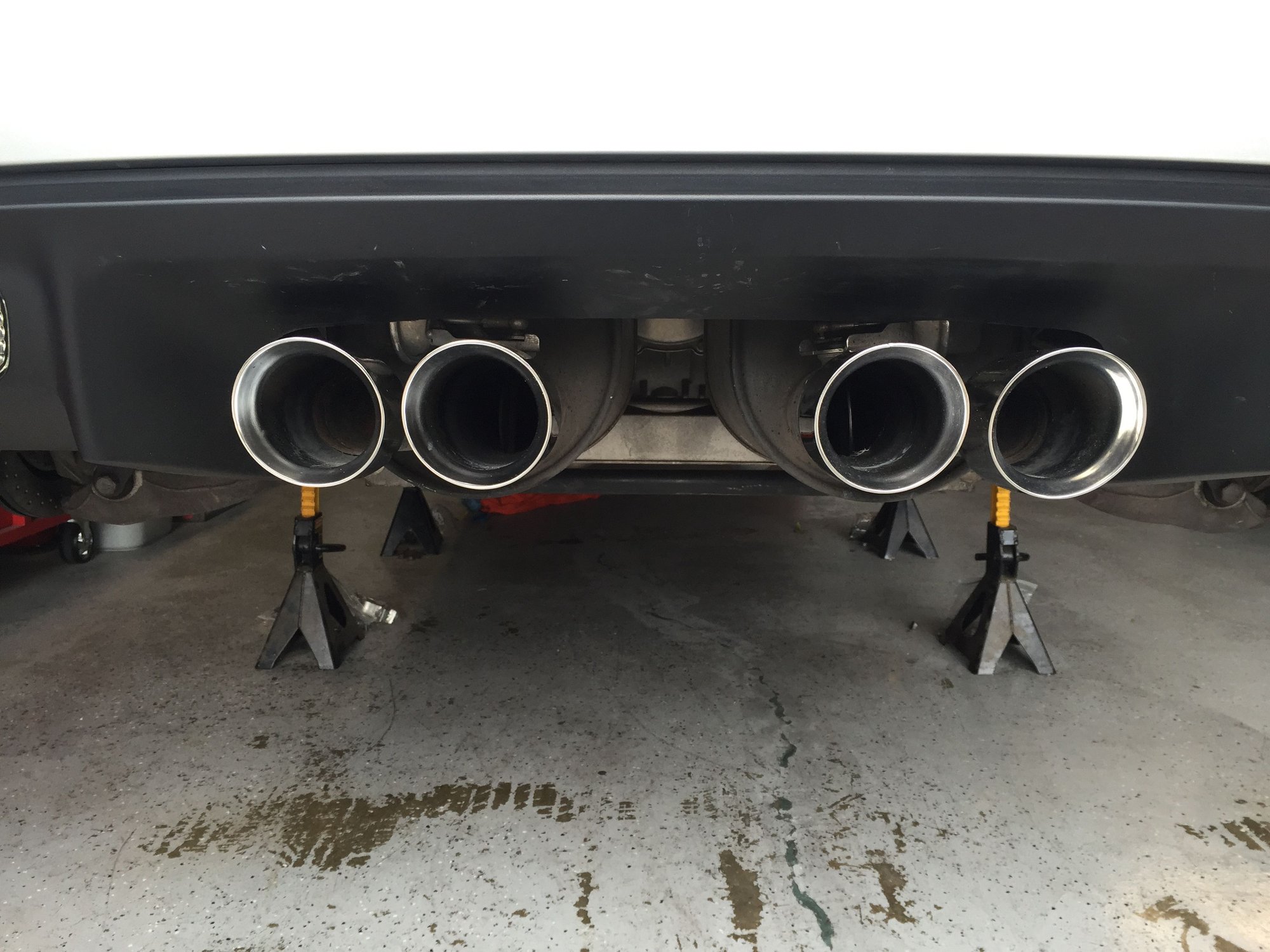

Thank you I have a set of Z06 Bimode exhaust, with NPP in a box controller.
