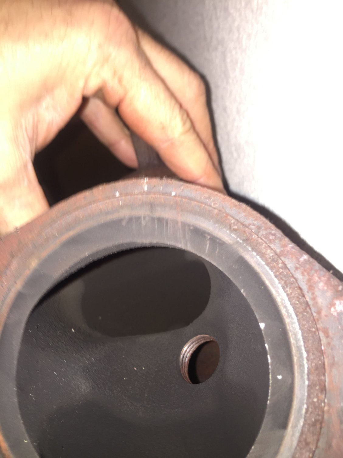

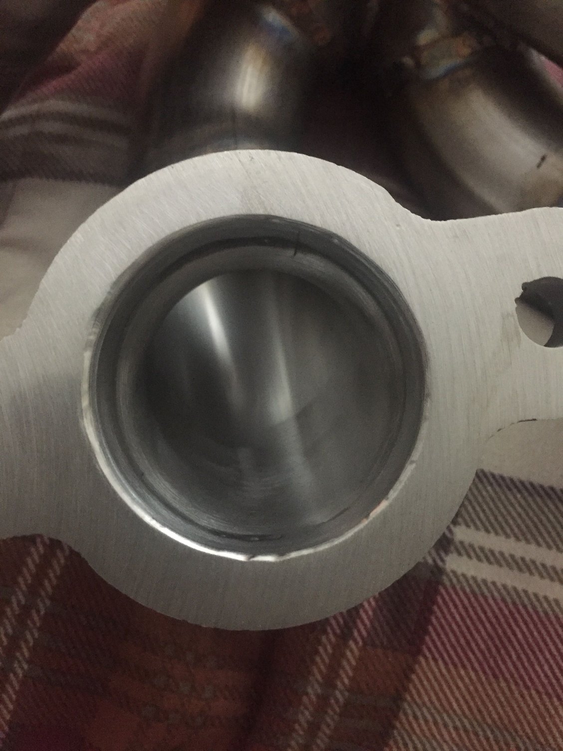

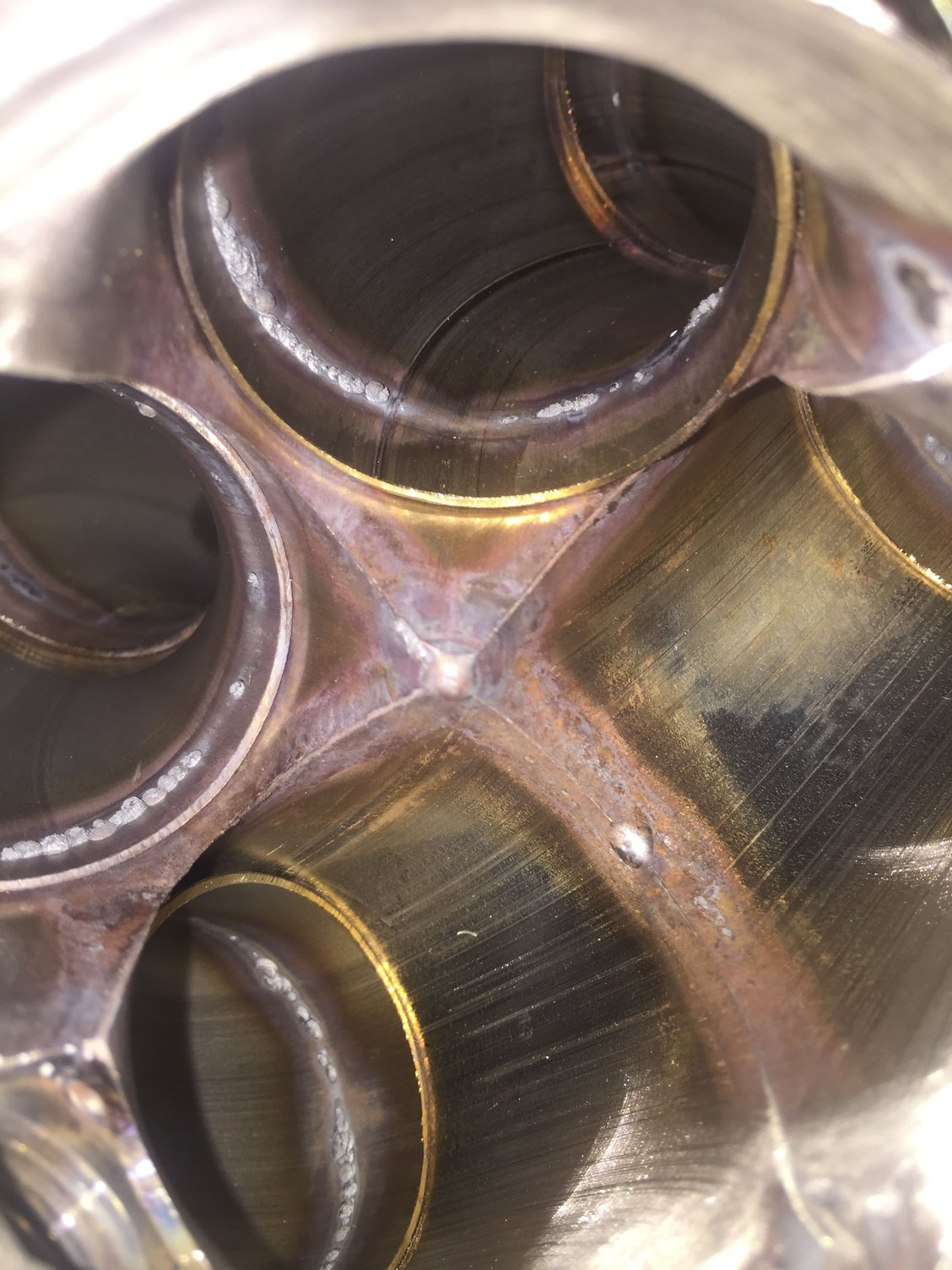

It was definitely worth it for me. I have an LS2 that is full bolt on including hooker shorty headers. There is no comparison to the stockers as my pictures show. I already had corsa extremes and did not want to pay for a z06 setup, plus shipping, plus for a shop to fab them to my A4. Sound is deeper and there is a small seat of pants bump. That being said, I do also have an airaid, ported vmax tb, ported fast 102 and a cow tune so I'm sure this all helps as well. Purchased mine direct from holly during their Xmas special for $675 delivered.
Notice the spiked merge collectors.
Stock collector

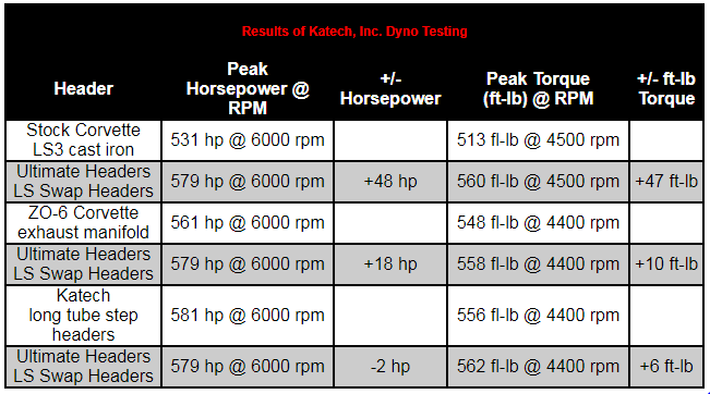

This is from a stock LS7 motor, so take it with a grain of salt, but on a chassis dyno at Katech:
http://ultimateheaders.com/dyno.shtml

The hookers have 3 inch collectors.

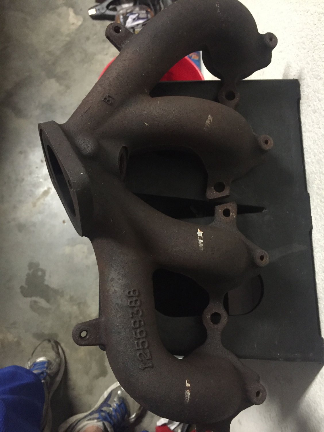

Understand exhaust scavenging and you will see why you pick up HP when you have a collector in play.
So shorty header as well at the z06 OEM manifold that does have a collector as well , is good for about 10~14HP gain.
Note, the reason that most will run with a Z06 system is that in states that you do have to do a visual smog test, the Z06 system does look OEM, and most inspectors will not pick up that the stock manifold and Cats system has been changed.
Long tube headers give a gain about 25-35HP due to the longer tube draw instead.
