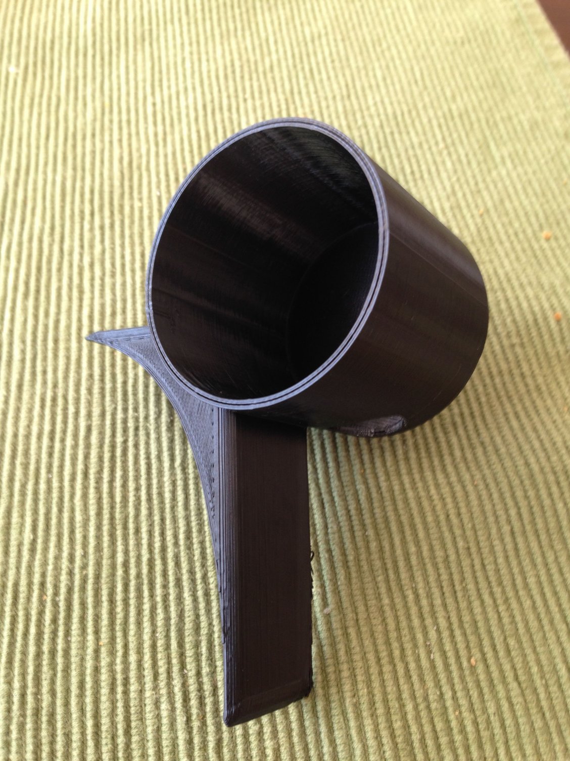

For information purpose, this is what the "raw" pod looks like coming off the printer. There are very small lines, or what I call the "traditional look of additive printing". Right now, one of the ways to do away with those "lines" is to wet sand with 150, then use a primer filler, went sand that and then paint the part. Not really different than if you were to build something out of fiberglass, but a lot less sanding for sure, by a factor of 100 at least lol

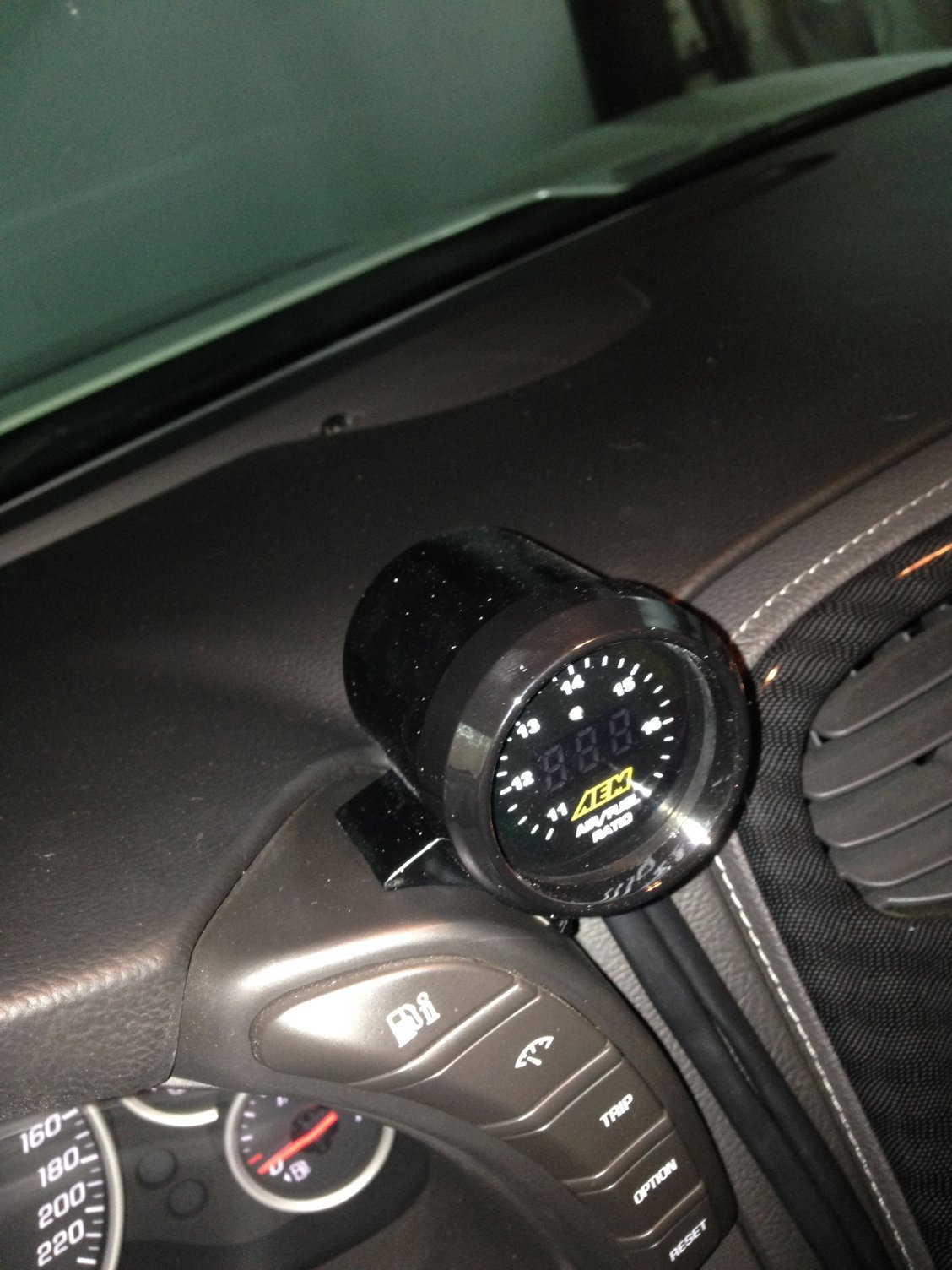

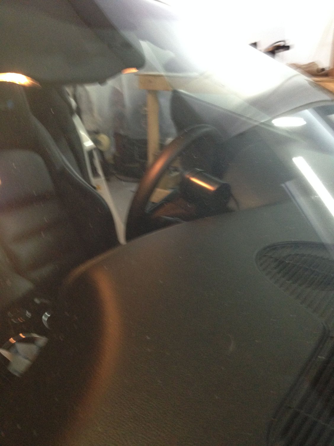

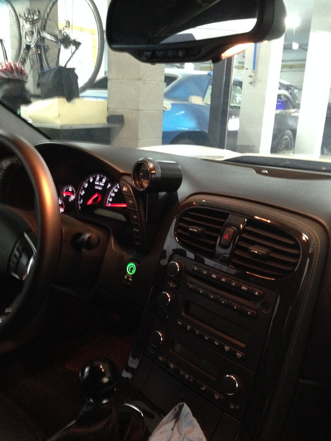

Mirage was kind enough to make one for my Diablo Trinity. I painted it lightly with 3m undercoat spray to add a little texture and have it blend in with the dash texture.
Wrapped one end with electrical tape for a snug fit.
Diablo pod installed
Finished! I like where it is mounted, I have a clear view thru the windshield now as opposed to using a suction cup windshield mount.
