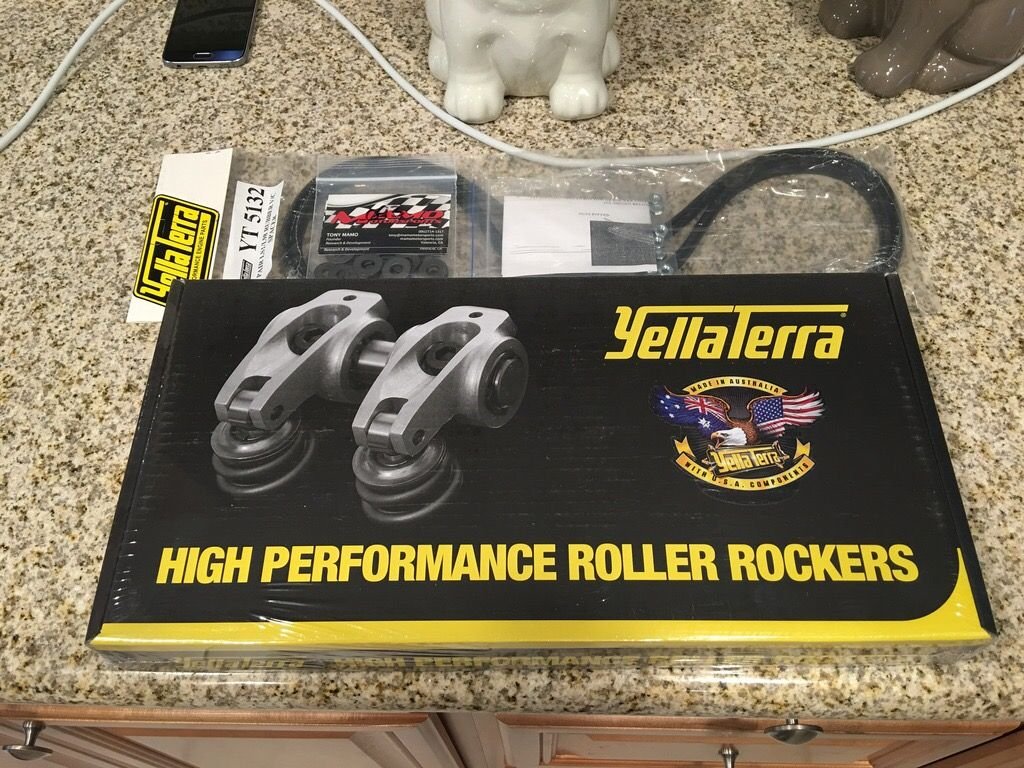

I went with a set of Mamo worked TF heads, could not beat the price. They are the as cast version worked by Tony. I have not got the set up dyno'd sense the install but I am not disappointed. I opted to get a set of YT roller rockers recommended by Tony. Contact Tony if your thinking about a set of TF heads.

I could have ran stock rockers on my TF heads but would eventually have guide issues from poor rocker geometry.
