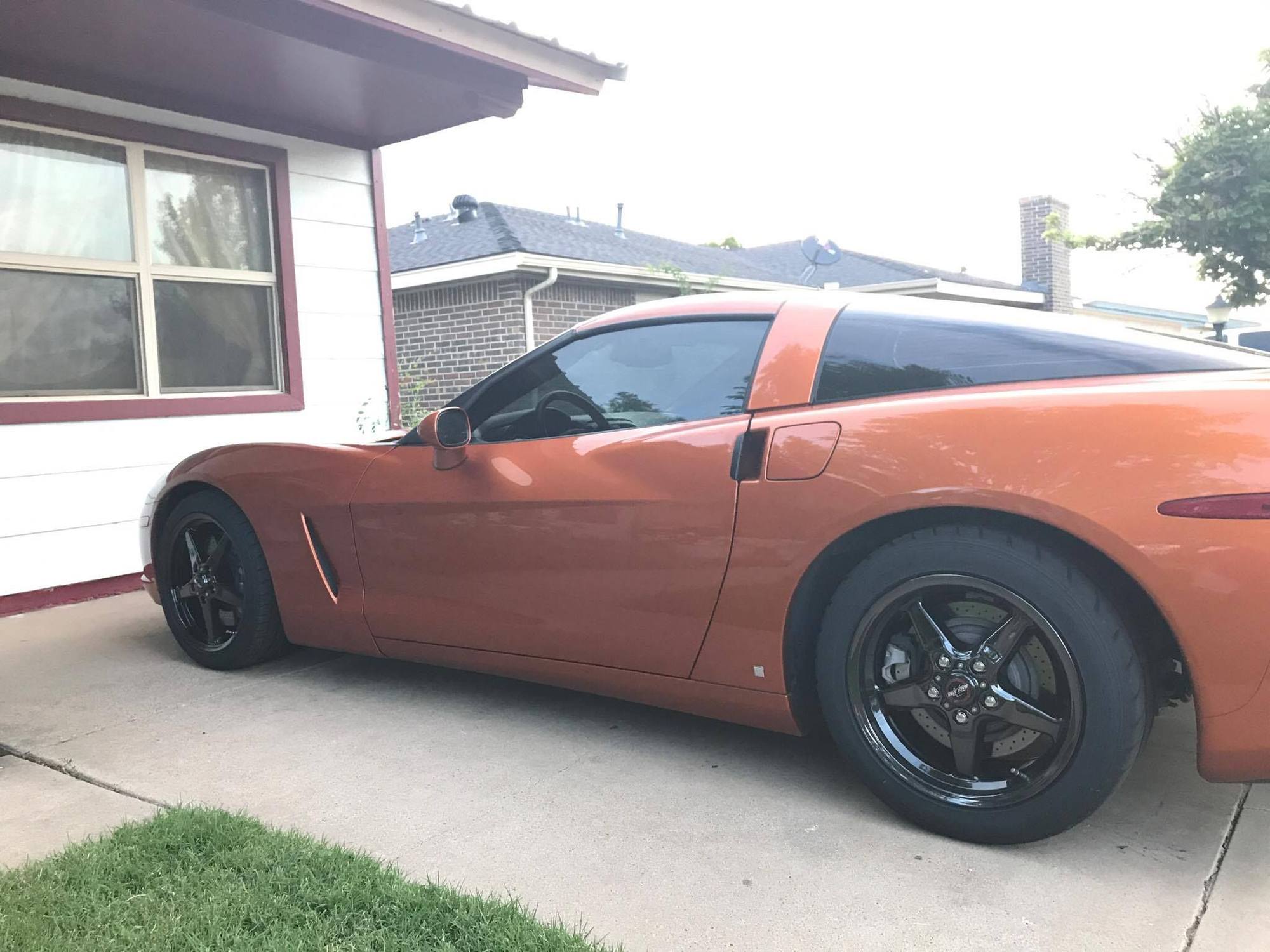

Here is a shot of that C6 Z51 with the 17x9.5 rears. Not sure why it wouldn't let me do it in PM.

Awesome! Looks like a 26 inch tire? Clearance from the caliper and rotor looks like plenty.
I believe so. I would have to go back in and see what he ended up going with. We don't sell the tires, so I'd have to go back through my messages for it.
