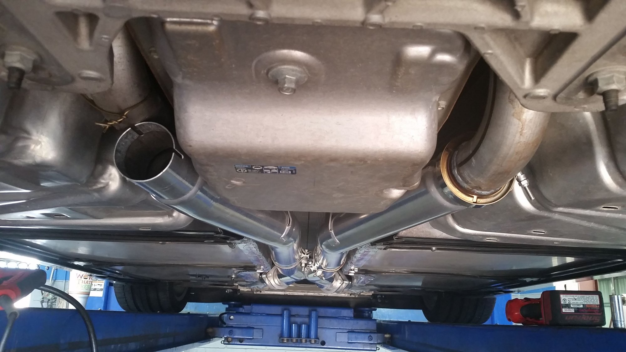

Yes, but with the lone exception of the slight, and easily fixable, angle difference of the X-pipe to the over-the-axle pipe.

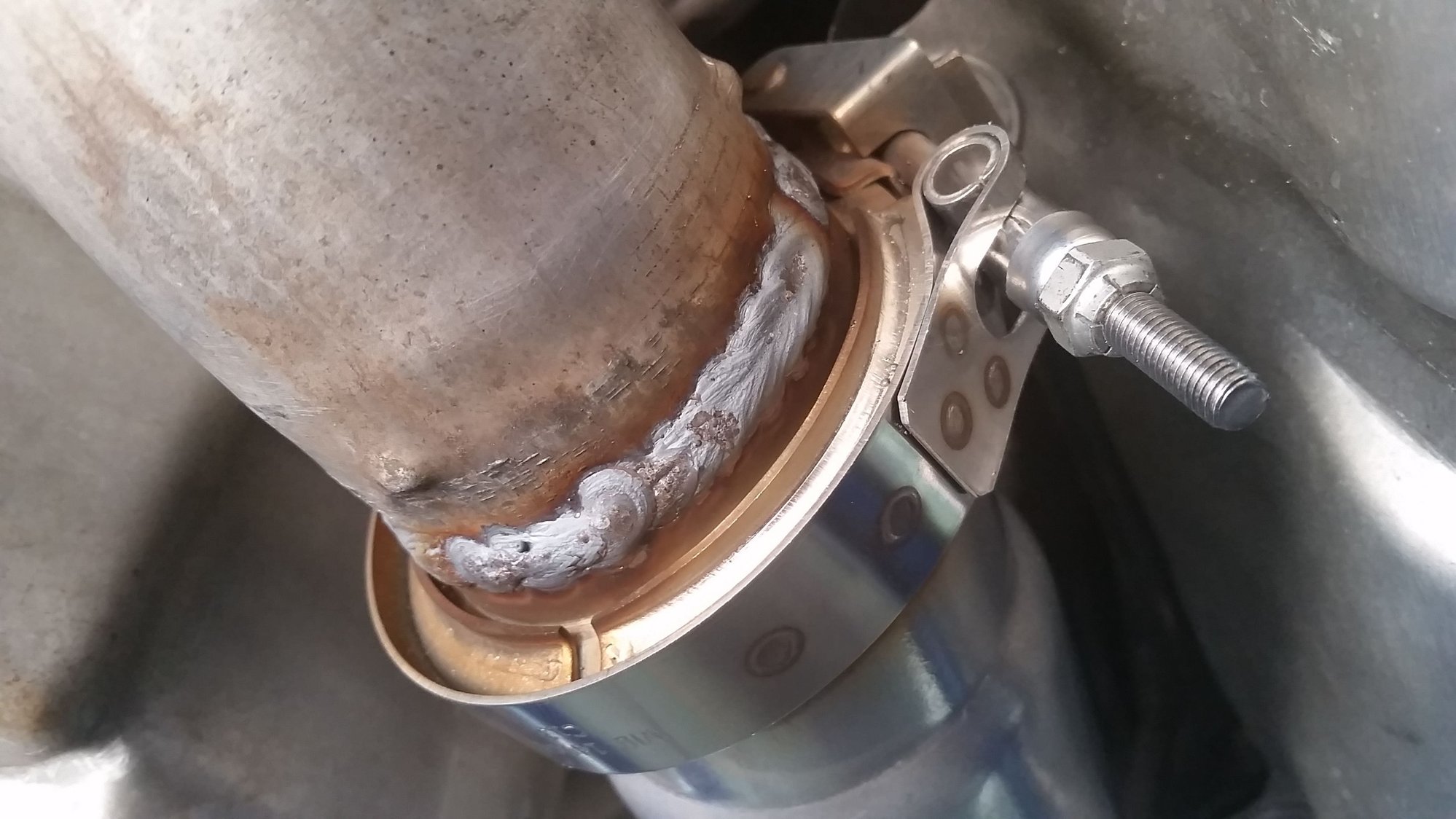

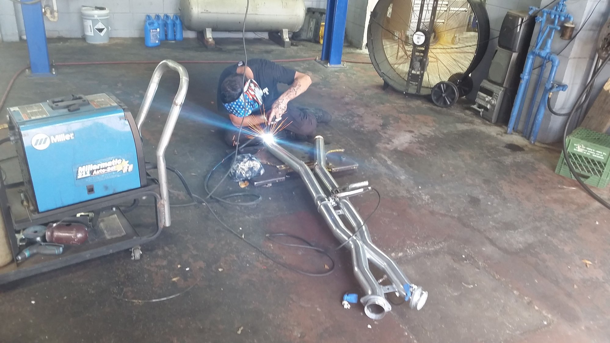

As HOXXOH said,and this is local shop fix for me.
S.S. V band clamp sourced form local PEP BOYS auto parts and welded on with S.S. wire.
After getting right angle on pipe, clamp was welded on each end and band holds them together
https://www.pepboys.com/product/deta...632?quantity=1
