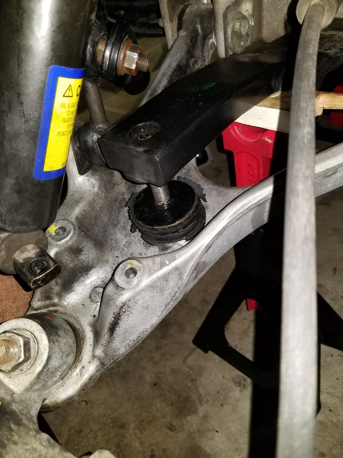

Thoughts on how I can get this the rest of the way out? The rear spring bolts were much easier to swap out but this front bolt won't budge any further. I have about an inch gap gap underneath but just can't seem to get a good enough grip on it.

back it in a little and cut it off and take it out the other way. or screw it all the way back and cut that off.

Just did this. I had to use a vice for the last few turns. After doing all four I wish I would of just lowered the factory fronts and cut the bushings off the factory rears...

Run it back in, soak it with penatrator oil, use a wire brush on the upper threads. A pick works works on the heavy rust. It will come out.

Thanks guys. Finally got it out, after oiling and working it loose. The car is officially slammed on all 4 corners with the new bolts. The stock bolts were in pretty rough shape. The car feels noticeably stiffer now which I wasn't expecting but not dissapointed.

you have more room if you disconnect the inner side of the control arm. If you insider a thin piece of hard plastic or aluminum, the ends hold up better. It's the side-to-side motion that destroys them.
