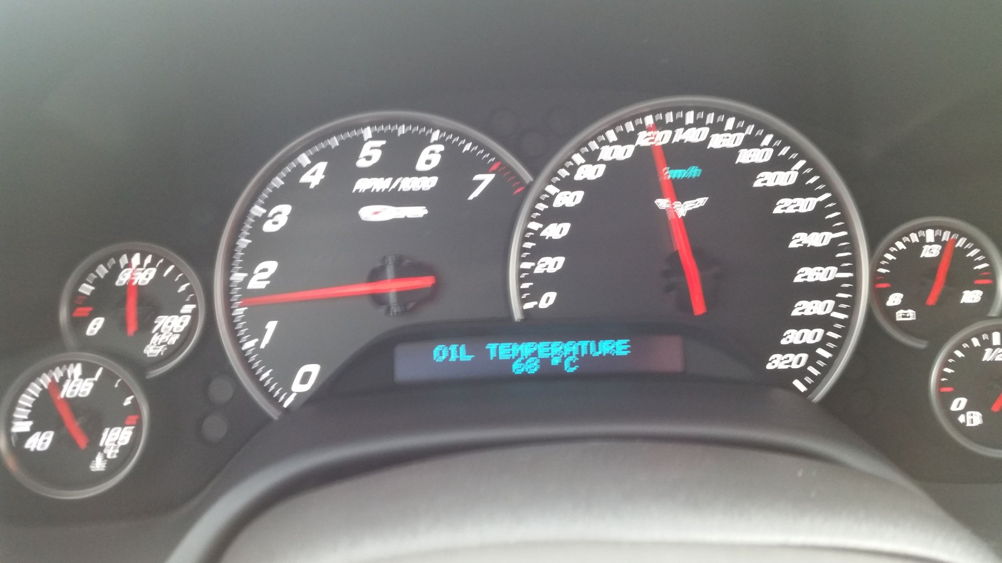

Here is what I read as posted by various car-oriented sites, such as Hot Rod Network. To boil it down (pun maybe intended), burning a kilo of fuel generates a kilo of water, most of which is going out the exhaust. But it's inevitable that some of that gets past the rings and into the oil. Unless the oil temp gets hot enough to boil off the water, it accumulates, mixes with sulfur dioxide (another byproduct), and forms acids that corrode, among other things, bearings. 220F (104C) is a good oil temp to boil off the water, and full synthetics can operate safely up to 300F (149C). A high-end engine (and I'm counting an LS3 in that class) is built to specs that also include oil quality and operating temps.
On the drive mentioned above, my oil temp stabilized at 104C, cruising at 120Kph (75 Mph). This to me was exactly right. When I slowed down a bit, the oil temp dropped. On the other hand, on your longer trip, your oil temp didn't exceed 68C, which to me may actually be doing your engine more harm then good, and probably dropping your fuel economy too. I'm sure that there's lots of debate around these issues. Right now, I'm just investigating to see if I'm going to need more cooling capacity based on where and how I plan to drive, and what to do about it if I do. I do appreciate your views, and those of others.

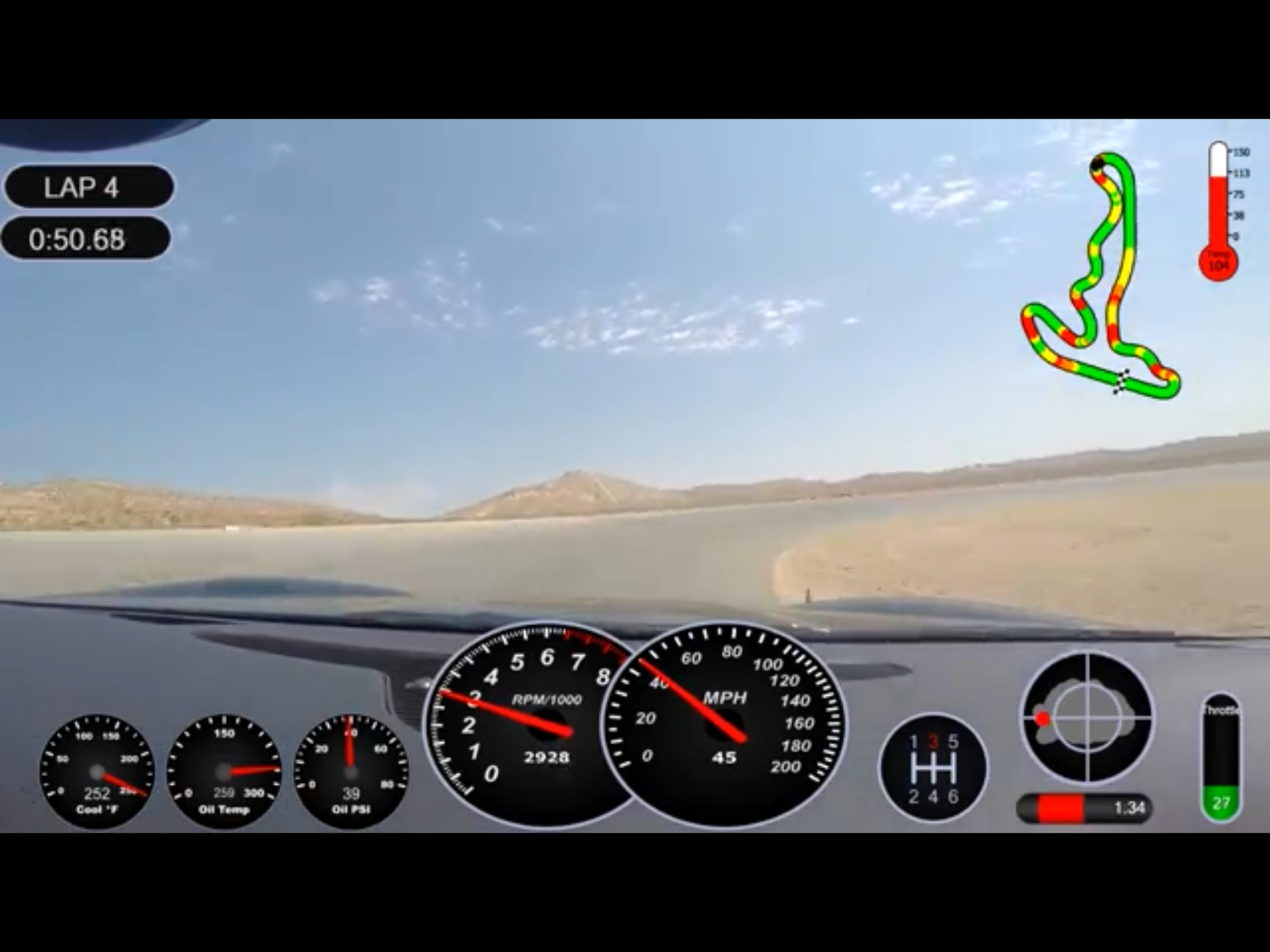

I didn't say that it never exceeded 68c. When I get into it it climbs up into the 90-100+c range for sure. With a z06 oil cooler up front, 11L of amzoil synthetic oil, cruising at 120kph at low rpm, regardless of my thermostat my oil temps would never pass 100c. 625+rwhp 7.0L running 9.1L/100 is fine by me lol. However if I had it idling in traffic it would definitely climb.
On another note, my car get its engine oil replaced often and sees the track plenty as its more of a weekend street&strip warrior than a daily commuter. So it gets put through its paces and sees heat and high rpm on the regular.
I purposely stay away from traffic with it but do take it to work from time to time. At the track we attempt to keep the engine oil warm but the coolant and intake cool.
I guess if you're thinking your temps are perfect, I don't understand why the need to upgrade. I am also curious if the C7 rad just fit right in.
