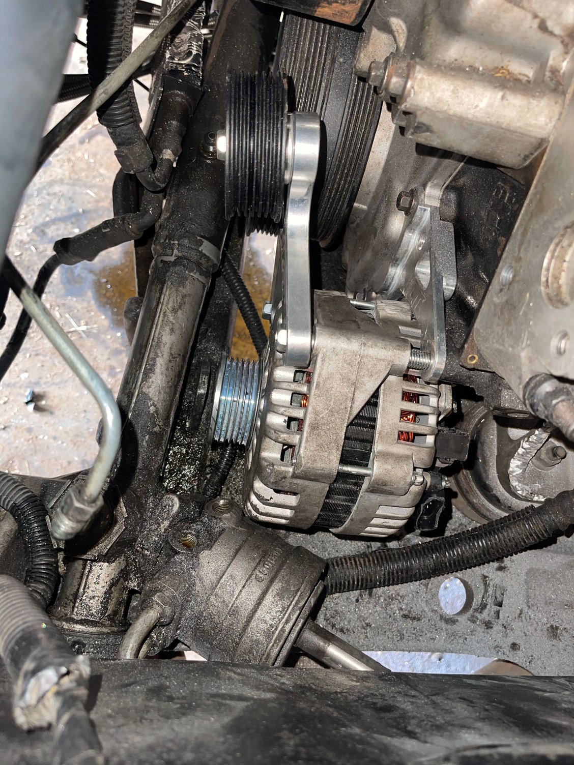

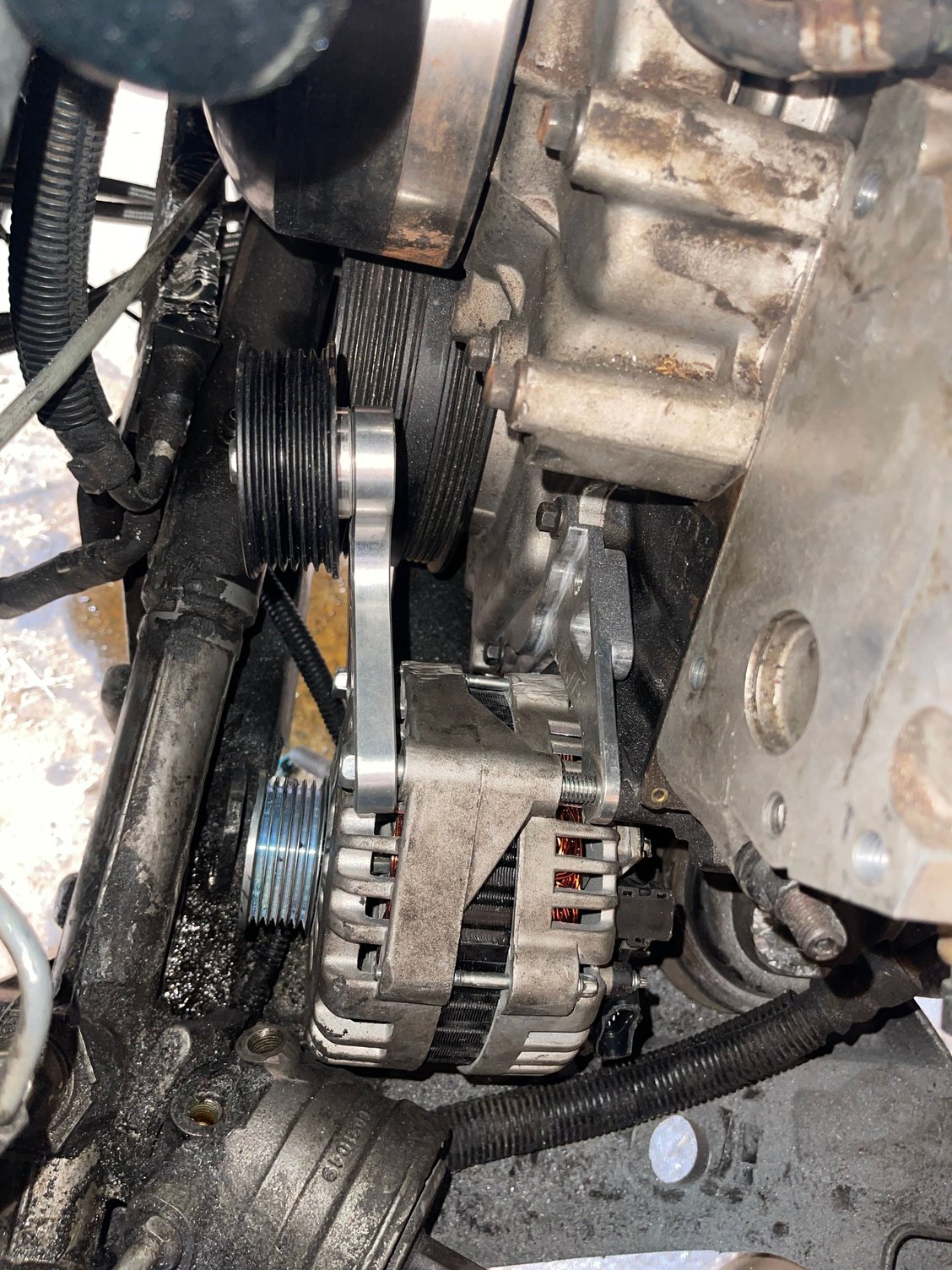

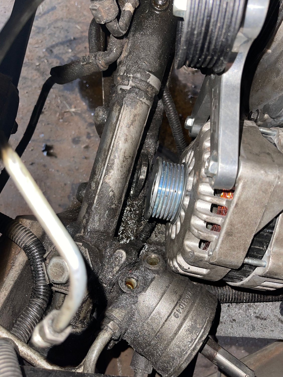

I'm not in a c6, I'm in a c5 but I've gone ahead and fired the trigger and got the low mount ict bracket and I have been grinding away at things trying to make everything fit and with the steering rack where it is in the c5 it will just absolutely not fit. I’ve attached some images that show where the problem lies. I’m thinking maybe a mini race alternator may work in this situation but this is absolutely no way without grinding through both the rack and the alternator to make things fit.
If it’s a C5 why don’t you post this in the C5 section ??
