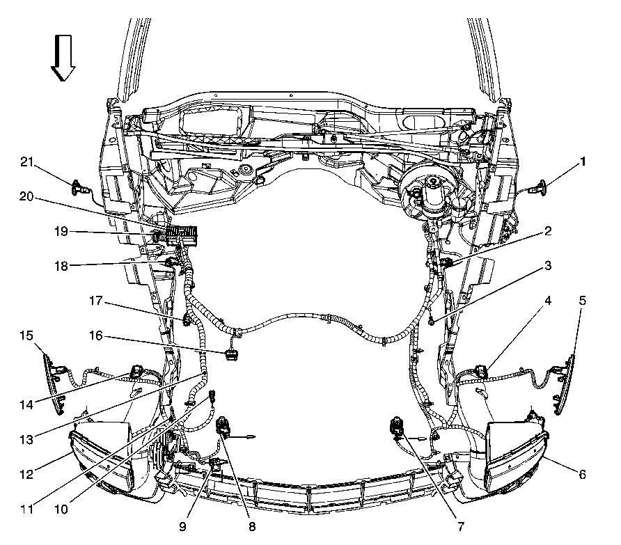

Old Jan 6, 2019 | 04:15 PM
Dano523's Avatar
Dano523
Joined: Dec 2013
Posts: 12,505
Likes: 3,632
Temp reading if from the temp sensor on the head.
Now actual temp sensor of the motor is easy to check as well.
So would say that you have an electrical problem in the wiring, and although the temp of the motor is not the problem, its the reading of the sensors due to electrical problems the cause of the codes/errors isntead.
So on that note, would check the connectors to the ECM and its ground point, as well as the connectors above behind the battery that leads down line, and wiring from point A to point B as well.
Hence straight shot from the ECM to most of the engine for wiring connectors,
But you have the C186, C180 and C166 (#3 and $4) connectors between the ECM and back of car/to the dash on some models as well.
Bluntly, with you living on the cost with higher salt water humidity in the air, it going to cause connector problems faster, and would dare to guess that the problem is one of corrosion on the connector in the series causing the problems.
