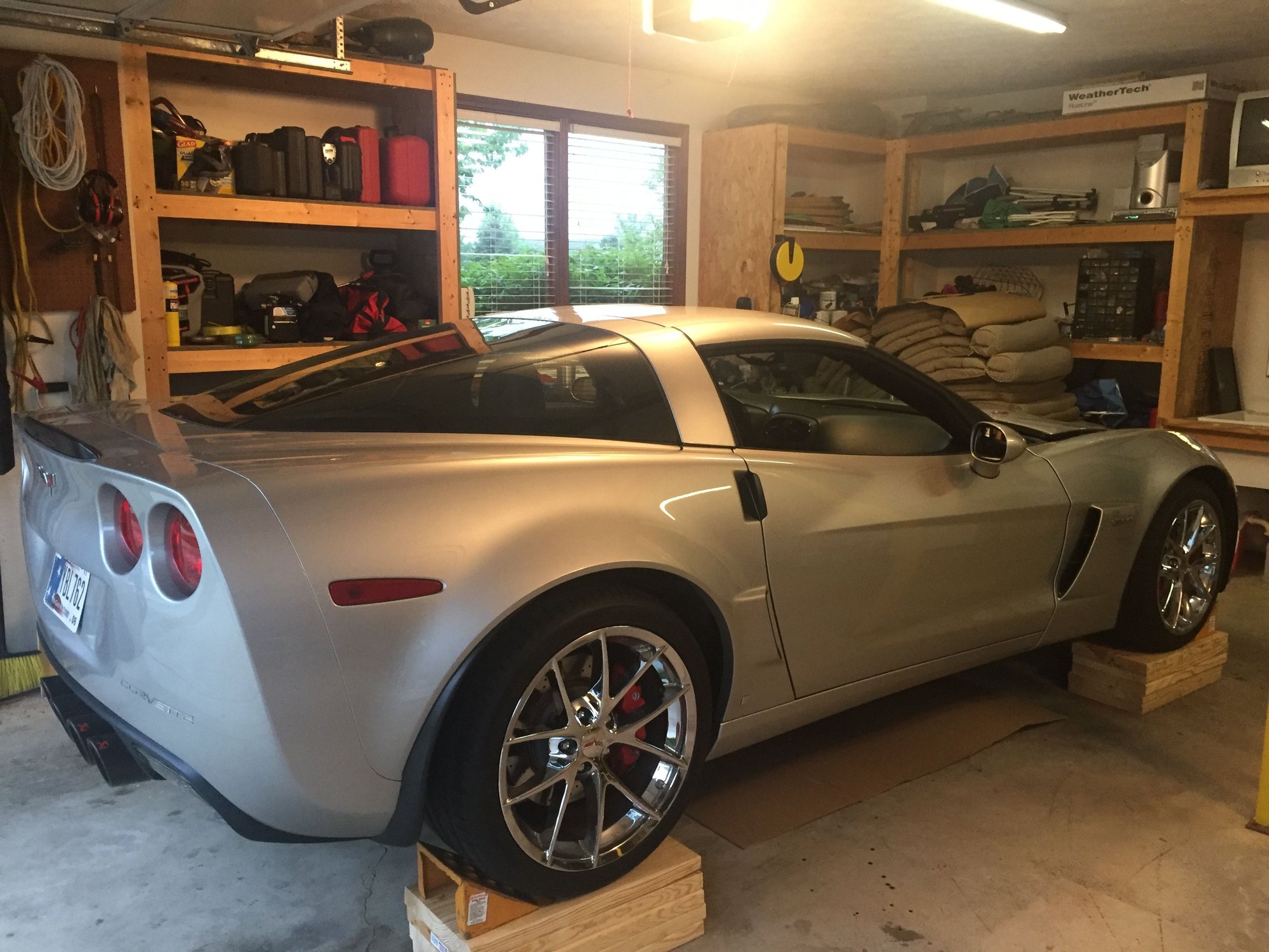

My first header install took about 5 hours, an hour of that was insulating clutch line, starter solenoid and o2 sensors wires. Jacking the car up was another 35 minutes.
My preferred method of lifting the car is by using 2X10's, 5 high. I have plenty of room under car and is solid on all 4 corners. Work your way around the car placing 2 at a time, on the second pass adjust any that get out of line and again on final pass.

thanks for the pic and info
