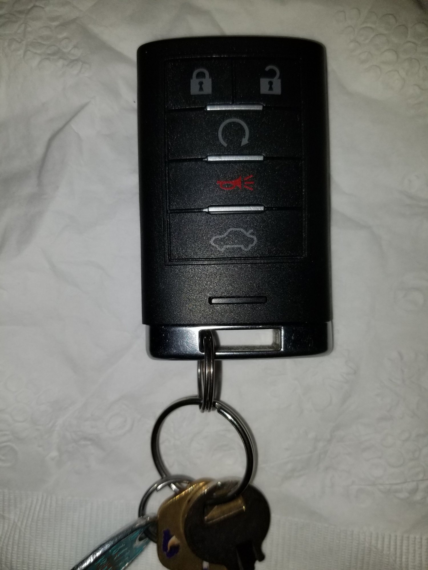

I had the 2 original fobs that came with my 2012 G.S. I use the #1 fob and gave the #2 to my wife. She's driven car once in 2 years. Her fob looks and works like new. My fob looks worn and only works about half the time. New battery or old battery doesn't matter. Some times it works and some times it doesn't. I found a new fob on line for $74 from Amazon.
The new fob looks just like the old one but doesn't have the Corvette logo but has a 5th button for remote start.
I wanted the new fob to be #1, the original #2 fob to remain #2 and the old #1 to become #3 just to keep in the safe as a backup. I used the long instructions in the owner's manual (which are different from the original post here). I'm not sure what happened but I think I exited the setup mode too soon. I programmed the new fob fine but it never promoted me to insert the 2nd fob. When I was done the new fob worked as #1. Neither of the other fobs worked at all. I then simply used the short method to add the other two fobs. Checked all features on all three fobs. Work great.
I CAN'T EMPHASIZE ENOUGH TO TURN THE KEY FULLY TO ENTER THE PROGRAM MODE. If you just turn it far enough to open the hatch it is not enough. I spent the first half hour just figuring that out. I'm a happy camper.
