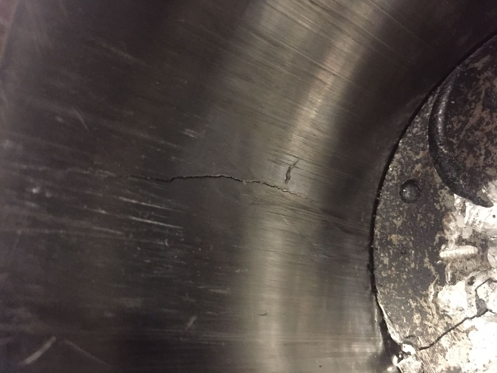

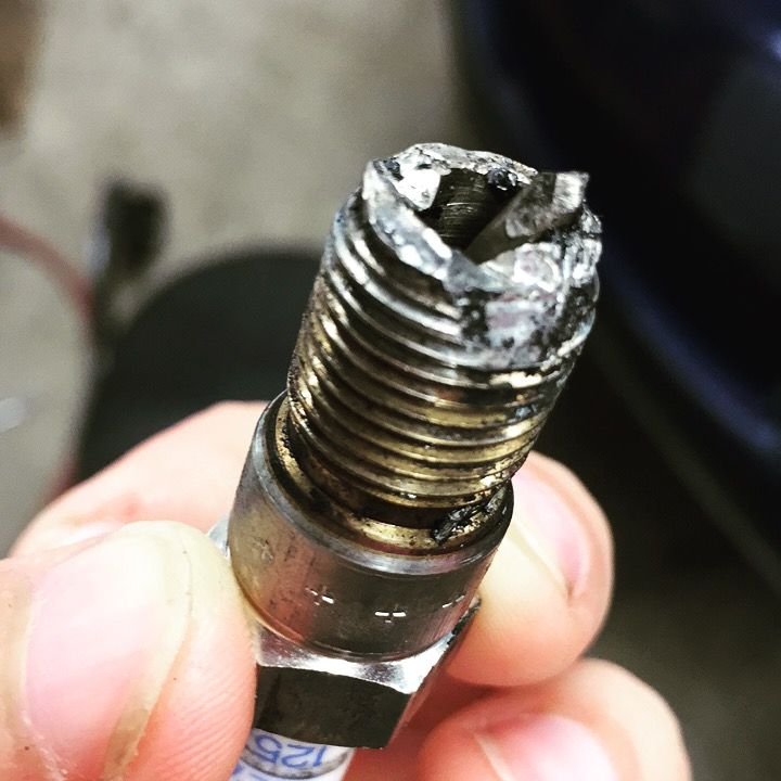

A while back I did what we all fear. My Z06 dropped a valve. Needless to say the tears came in buckets. I had the car taken to a shop to asses the cost. I was quoted the $14,000. I laughed and had the car towed home. I did so research found a used engine with low miles, grabbed a buddy and we swapped the engine in the garage. Took us 5 days working after work from 4-8. It was so much easier than expected. We did it would a lift. Just an engine hoist, trans jack, and a couple floor jacks.
Some pics of the swap and damage.
All in cost $5,600.
