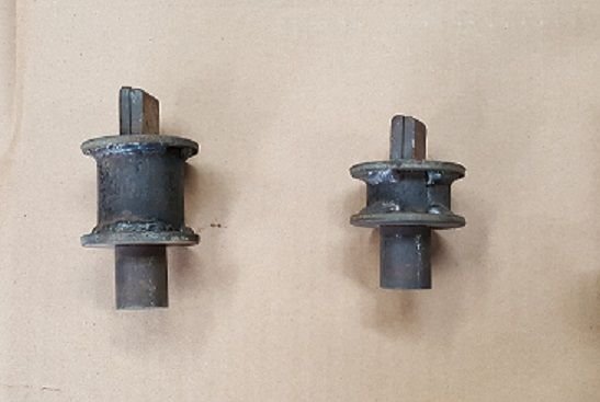

I use these on my floor jack
Then after I'm off the floor high enough to use jack stands I have these that I put on the jack stands. I know these mark up the frame, but it is peace of mind that it won't slip off.
They are long enough to stay engaged as I raise or lower it.
My way overboard $0.02.
